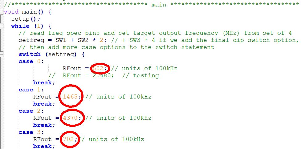

Hello
I can't find where to tighten the registers for 4 frequencies in the program for a peak 12LF1552
Thank you for your help
Michel

Michel
You need to modify the fatcontrol.c variables in the section of code highlighted below:
The output frequencies are multiples of 100kHz, so 502 = 50.2MHz, 1465= 146.5MHz, 4370 = 437MHz etc.
Clive G3GJA

Hello Clive
thank you for the answer
I understood for 11030 (for 1103Mhz)
Michel F6FGD
