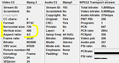

Post by F6DZP » Mon Jan 04, 2016 2:09 pm
We think the camera may be 16:9
Sure, the DV camera is in 16:9 mode.
with incorrect 3:2 (720x480) description in the TS headers
No: 720x480 is the correct description for 16:9 D1 standard
The TS transmitted by HamTV is in 16:9 format NTSC_D1 = 720x480.
720x480 is the D1 picture size that gives a DV camera set in 16:9 _ NTSC
720x480 is the D1 picture size that gives a DV camera set in 4:3_ NTSC
720x576 is the D1 picture size that gives a DV camera set in 16:9 _PAL
720x576 is the D1 picture size that gives a DV camera set in 16:9 _ PAL
The camera onboard ISS gives a composite NTSC 16:9 signal
In the D1 standard "Video world" we don't have "square" pixels like in the computer world.
720 pixels are digitized for each line in both modes and the choice of 4:3 or 16:9 gives us the way we must show the picture.
( if you look at the DV encoded file from a DV camera you will see 720x480 pictures encoded with a Mjpeg codec . If you change the 4:3 mode in 16:9 mode, you will see the same amount of "rectangle" pixels by line : always 720!
This is only the "length" of the rectangle that changes)
So when we want to display a 720x480 Mpeg2_16:9 encoded signal, we show on a computer (= "square" pixels) 854 pixels by line.
The Minimod Mpeg2 encoder inside Hamvideo is set in D1_NTSC format, so it gives us 720x480 pictures digitized from a 16:9 NTSC analog signal with 480 lines
BUT THE 16:9 flag has not been set!

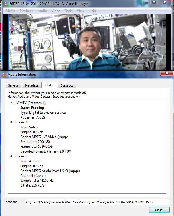

You can see that we stay with the 4:3 display format. So, by default, VLC and other rendering systems will show us a 4:3 picture if we don't force them to the 16:9 display format.

In ISS mode, Tutioune knows that we are in 16:9 display format, so shows us 854x480 pictures as it must do. ( EDIT : NO, using today version Minitioune shows a 3:4 picture inside a 16:9 black rectangle, see the explanation in my next post)
When a video is digitized, we cannot know the format of a picture by looking only the number of pixels by line and the number of lines.
a 480x480 encoded picture can be a square, a 4:3 rectangle, a 16:9 rectangle or anything else....
The video of Koichi Wakata I have recorded and put on Youtube is shown in 16:9 format.
https://www.youtube.com/watch?v=EpFzbKvK1pk
You can see the difference with the same video shown in 4:3 format
https://www.youtube.com/watch?v=61GTGTOa8AE

Post by F6DZP » Tue Jan 05, 2016 7:34 am
I still don't understand why the blue line on the blank HAMTV transmission is displaced into the left of the image compared to the unstretched TS played in VLC?
I have spent more time to understand what happens:
- the camera is set in 19:9 format and we use the composite output.
- the Mpeg2 encoder digitize and encode a 720x480 picture size video, but the 4:3 aspect ratio is indicated in the TS
- STB or PC using software will want to display in 4:3 format
In Tutioune/Minitioune I force the display to be in 16:9 (854x480 or 960x540), BUT the Microsoft renderer continue to display a 4:3 format inside a 16:9 picture, so we have a 4:3 video with 2 black vertical zones at each side and the left black zone has a vertical blue line that show the separation.
It was difficult to really understand what happened, because HamTV has no camera plugged, so no signal to digitize.
Last year when we have made the test receiving HamTV, Tutioune was used only for receiving/measuring, correcting and recording the TS. The renderer used was VLC (receiving the TS via UDP) set in 16:9 format with Vcam set in 16:9 format(854x480) and FMLE set in 16:9 format 854x480 for streaming to the BATC server.
So, we have never yet used Tutioune/minitioune for rendering. It is only with the last version of Tutioune/minitioune that I try to render the video inside Tutioune/minitioune, but had only black picture from blank transmission.
Yes I have seen early that I had this blue line in Tutioune/Minitioune display, but knowing that there was no signal given to the mpeg2 encoder, supposed it was a strange data/noise? taken by the mpeg2 encoder that has nothing to digitize, and without any true video to look at, it was not easy to find what exactly happened.
So today, if we want to display a good 16:9 picture, we have always the solution to use VLC forced in 16:9 format.
I will work on that immediately to find a solution for rendering a good 16:9 aspect ratio inside Tutioune/Minitioune.
I apologize for that inconvenient in Tutioune/Minitioune display and I will fix that as soon as possible.

Post by F6DZP » Tue Jan 05, 2016 2:50 pm
The new Minitioune version is available for download.
http://www.vivadatv.org/viewtopic.php?f=60&t=452
You will have now the 16:9 video with the good Aspect Ratio.
The mpeg2 video is coded with a 720x480 definition, as it is defined being 4:3 format, the decoder gives a 720x480 video to the Renderer set for 720x540 forced in 16:9 format , as it is in reality a 16:9 video, photo in Minitioune are taken with the 960x540 definition and video in Minitioune can be set to 629x354 or 1024x576 or more, depending of the zoom setup..
