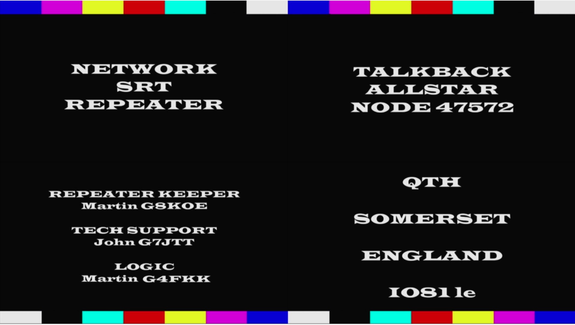

NEW LOOK FOR MY SRT REPEATER
73's
Martin
G8KOE
73's
Martin
G8KOE
- G4FKK.jpg (139.06 KiB) Viewed 817 times

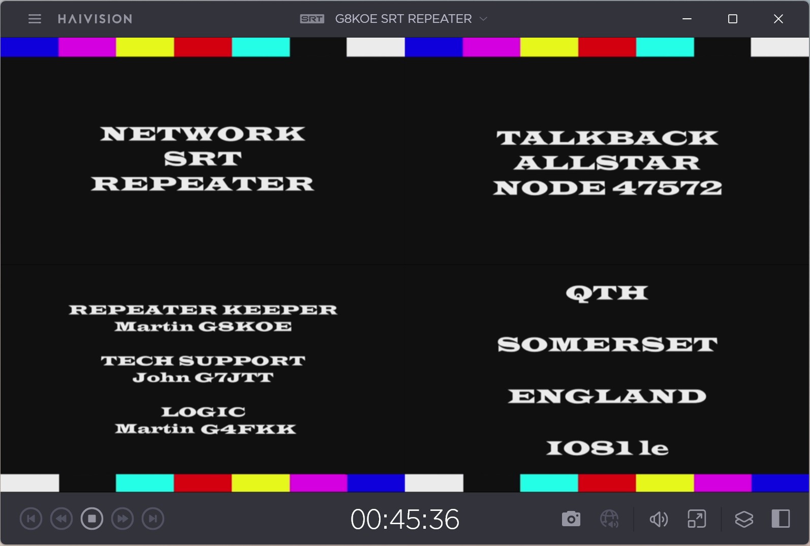

Re: Secure Reliable Transport
Haivision Play ISR Video Player
https://www.haivision.com/products/download-play-isr/
This works well for receiving my SRT REPEATER and it's FREE
73's
Martin
G8KOE
73's
Martin
G8KOE
- SRT-PLAYER.jpg (137.64 KiB) Viewed 614 times
