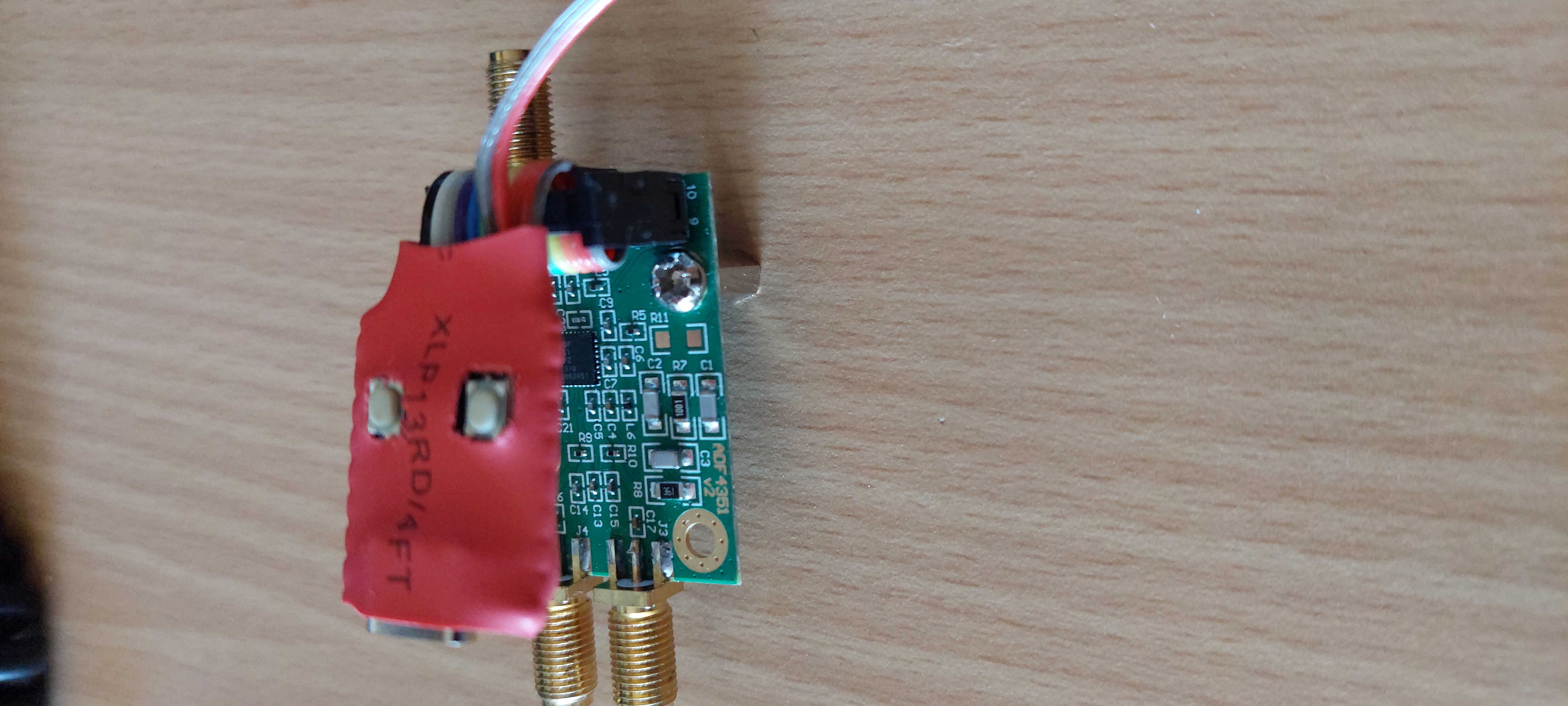

An alternative to the PIC controller is the RP2040 zero. Cheaper and a breeze to program. Shown controlling the SV1AFN PLL.
Wayne VK5BI
Wayne VK5BI
