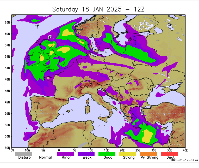

Yesterday afternoon and evening saw some good tropo - Rob was getting into GB3SQ...
Looks promising for tomorrow for the UK at least. Anyone around want to try 70cms?
Other bands possible with advance warning.
I'll be at home JO01AI09 just 100m from the Greenwich meridian.

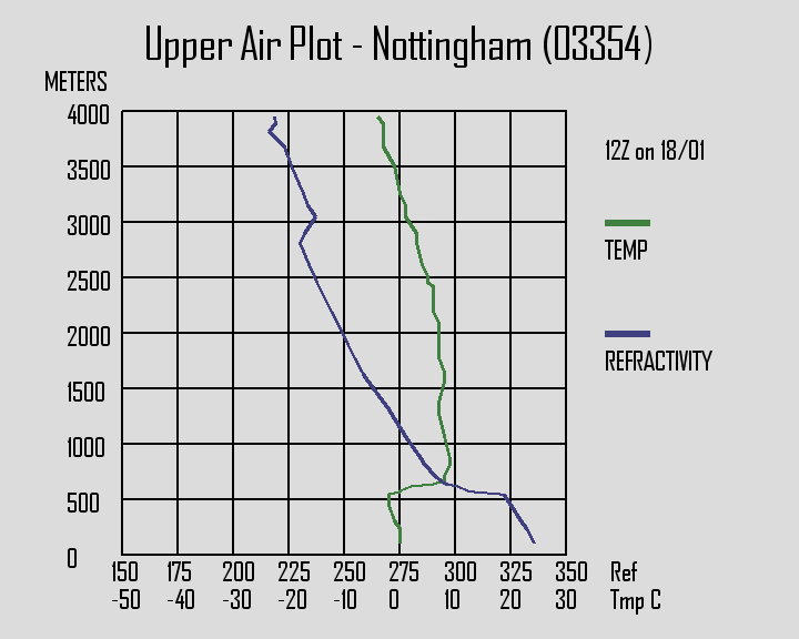

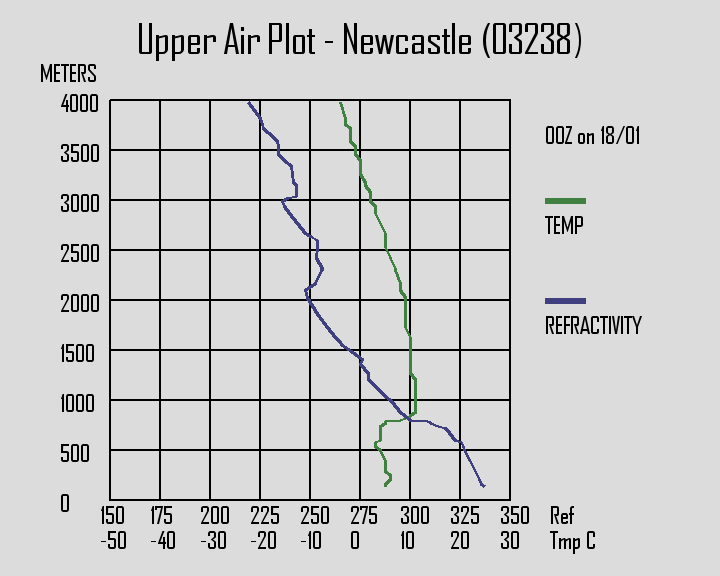

I Have 70cm antenna up here at home but still odd conditions!
Hearing 2M FT8 well into Germany using just a vertical antenna! but 2m and 70cm uk beacons are weak.
I think its favouring 2m more than higher bands...
Inversion layer is about 600m up at Nottingham, and 800m up at Newcastle, probably explains the good long dx but not much 'local'...

Hi Rob. Please will you be kind enough to post a link to those upper air temp plots. Very interesting.
Russ.

Hi Russ,
I generate them from Met Balloon sonde data, the images don't get published anywhere (could be done) but they can be seen on GB3KM's carousel often.
The raw data for the soundings can be found here:
https://weather.uwyo.edu/upperair/sounding.html

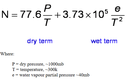

I used a calculation from Mike G0MJW to get the Refractivity figure, you can find that info here:
http://www.mike-willis.com/Tutorial/PF6.htm

I was going to ask the same question!
The plots are great - be good to get them published on a daily basis somewhere, I'm sure BATC would be willing to host them if it helped.

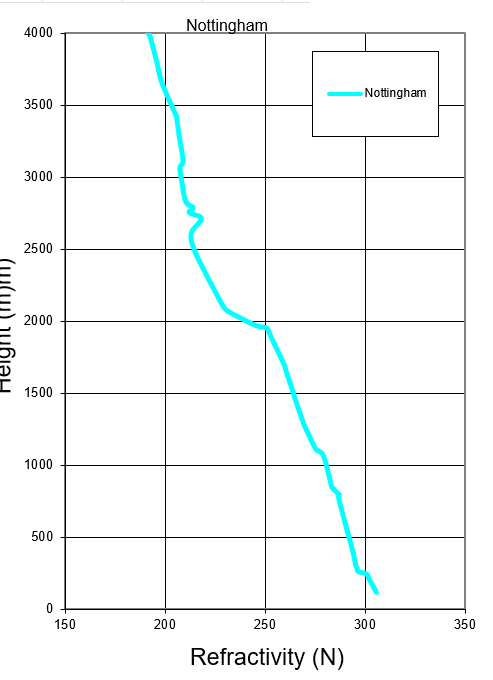

If you want to generate something in N units process the text file using a regular expression or similar in bash or as I did, just drop into an excel spreadsheet. I see I last did that in 2006. Will it still work? Sort of. Just needed the right columns selecting.

Here is what I have used to make the graph - the column orders have changed maybe so might need to adapt test to columns in excel, we only need 4 of them, HGHT, PRES TEMP and MIXR in columns A, B, C and D. Then calculate in excel.
A B C D E F G
HGHT PRES TEMP MIXR
118 1004 3 3.74 276 4.756866359 305.5763174
149 1000 3 3.73 276 4.744147465 304.3894009
206 993 2.4 3.58 275.4 4.543465438 302.1439381
247 988 2 3.48 275 4.410138249 300.5474587
263 986 2.6 3.03 275.6 3.848239631 296.5233993
I first change from centigrade to Kelvin simply because it makes the next bit easier.
I.e. Column E3 has "=C3+273" in it - the temperature in K
Column F3 has "=D3*E3/217" in it - what I call e in the equation on my website, the water vapour partial pressure.
Column G3 has "=77.6*B3/E3+373000*F3/(E3*E3)" in it which is the refractivity in N units.
So then just plot N as an XY graph against height.
Screenshot 2025-01-20 173627.png (31.43 KiB) Viewed 7315 times
Not sure this is entirely accurate but good enough for our use, so use at own risk. Obviously if you wanted a web version you would simply do the calculation in a scrips and send it to a plotting package.
