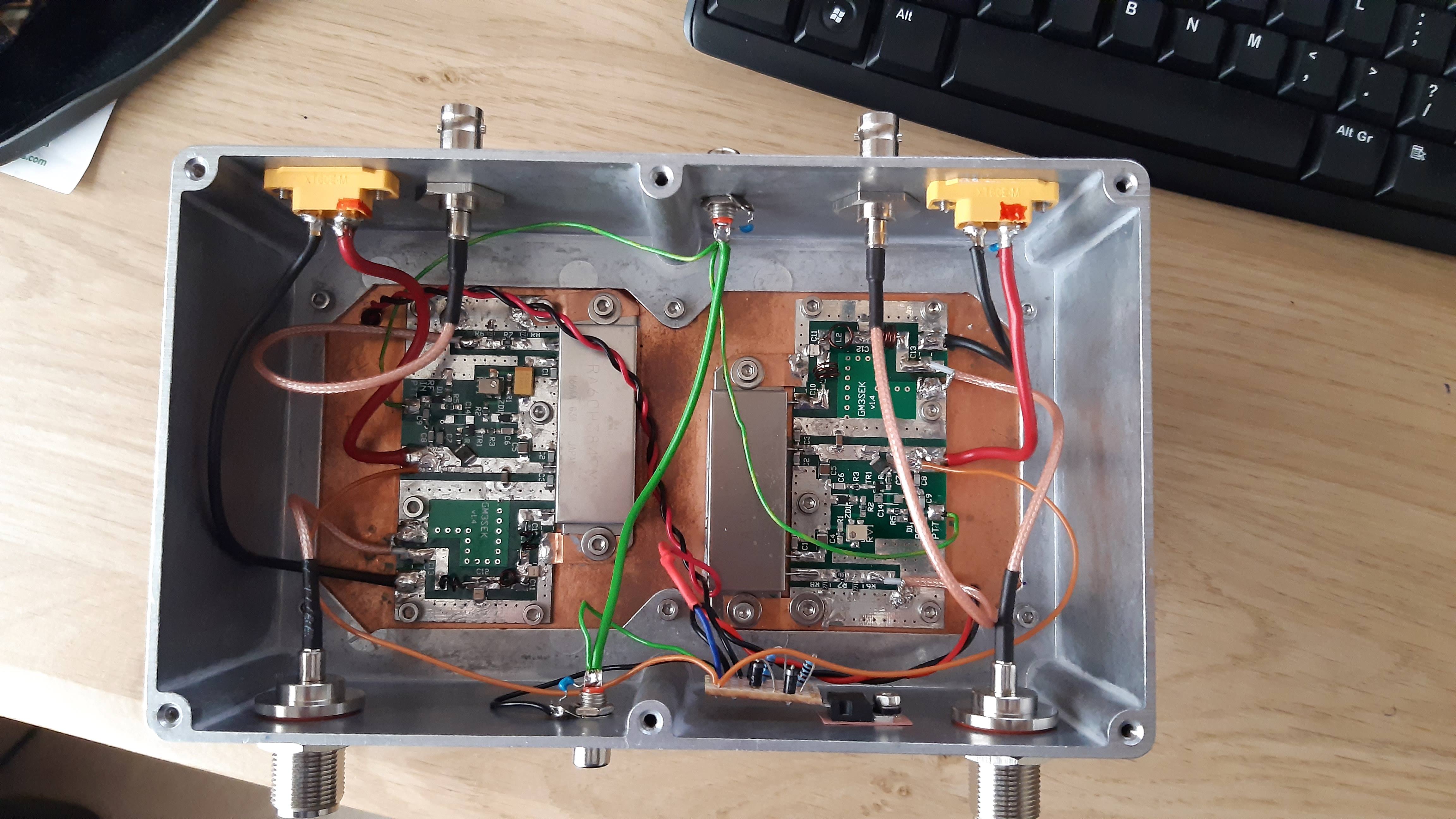

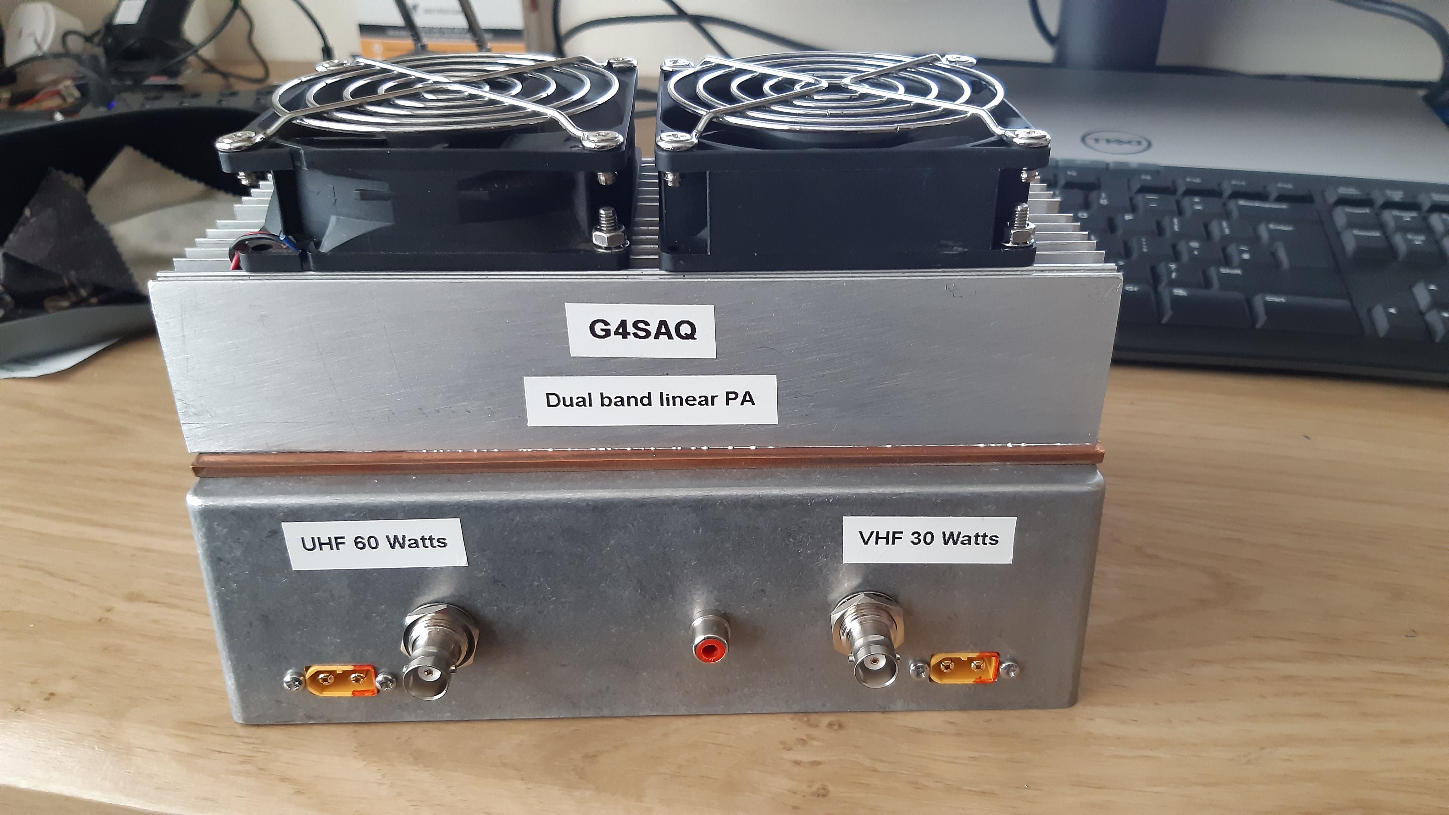

I agree that the advice to sand these devices is highly questionable. Mitsubishi know what they're doing and made the flanges concave for a reason. I am attaching the Mitsubishi mounting instructions. The 23cms module now sells for over £100 (only a few left), so it's worth looking after them.
Like others, I mounted mine in a Hammond die cast box but instead of fixing the module to the Hammond, I cut an aperture in the box and placed a piece of 3mm copper heat spreader on the outside, between the box and the heatsink. The module is screwed down directly onto the copper. There is a lot of good advice about ensuring a good ground connection. I followed GM3SEK's advice to run wide copper strips from under the heads of the mounting screws to the top surface of the PCB.

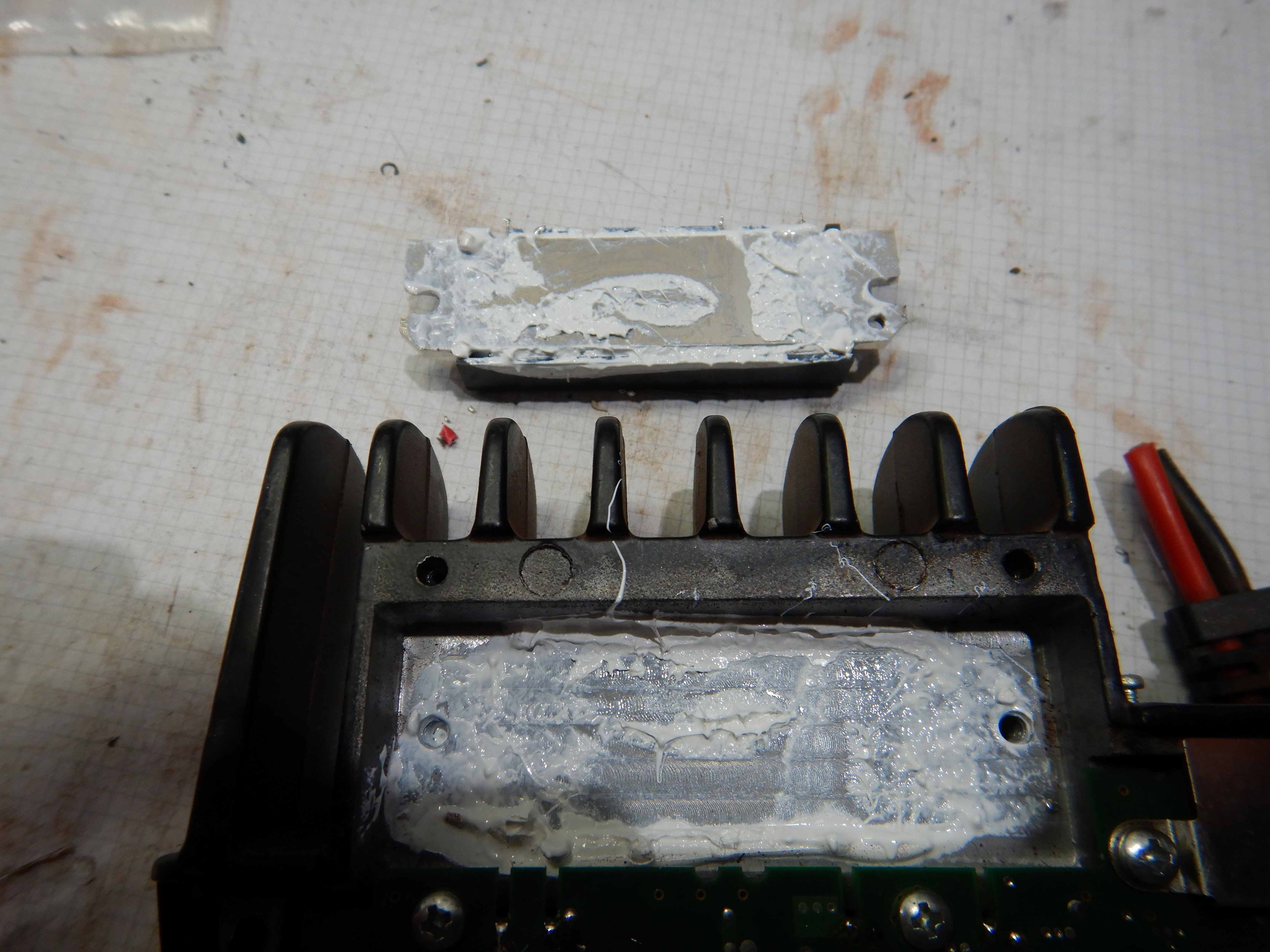

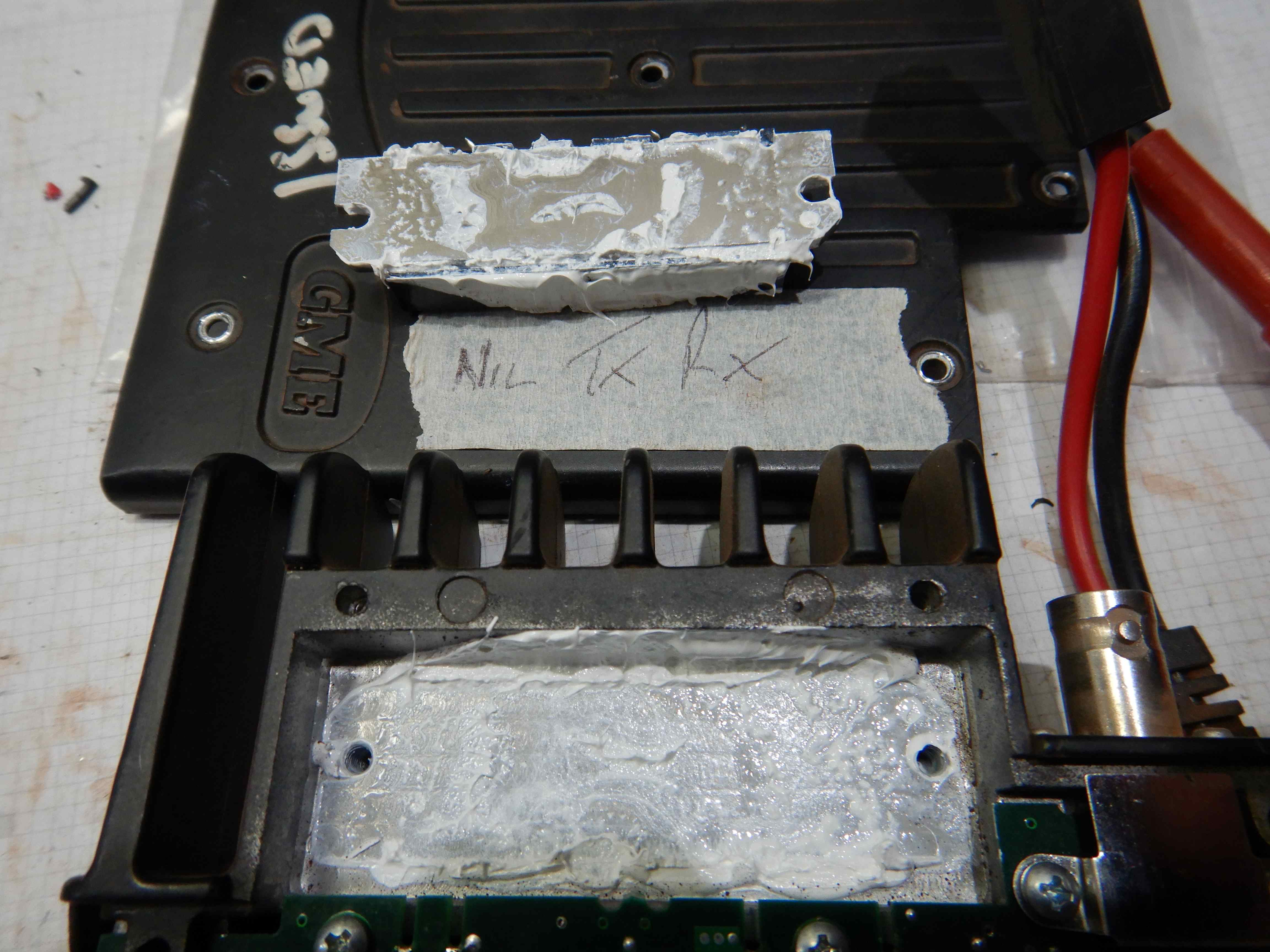

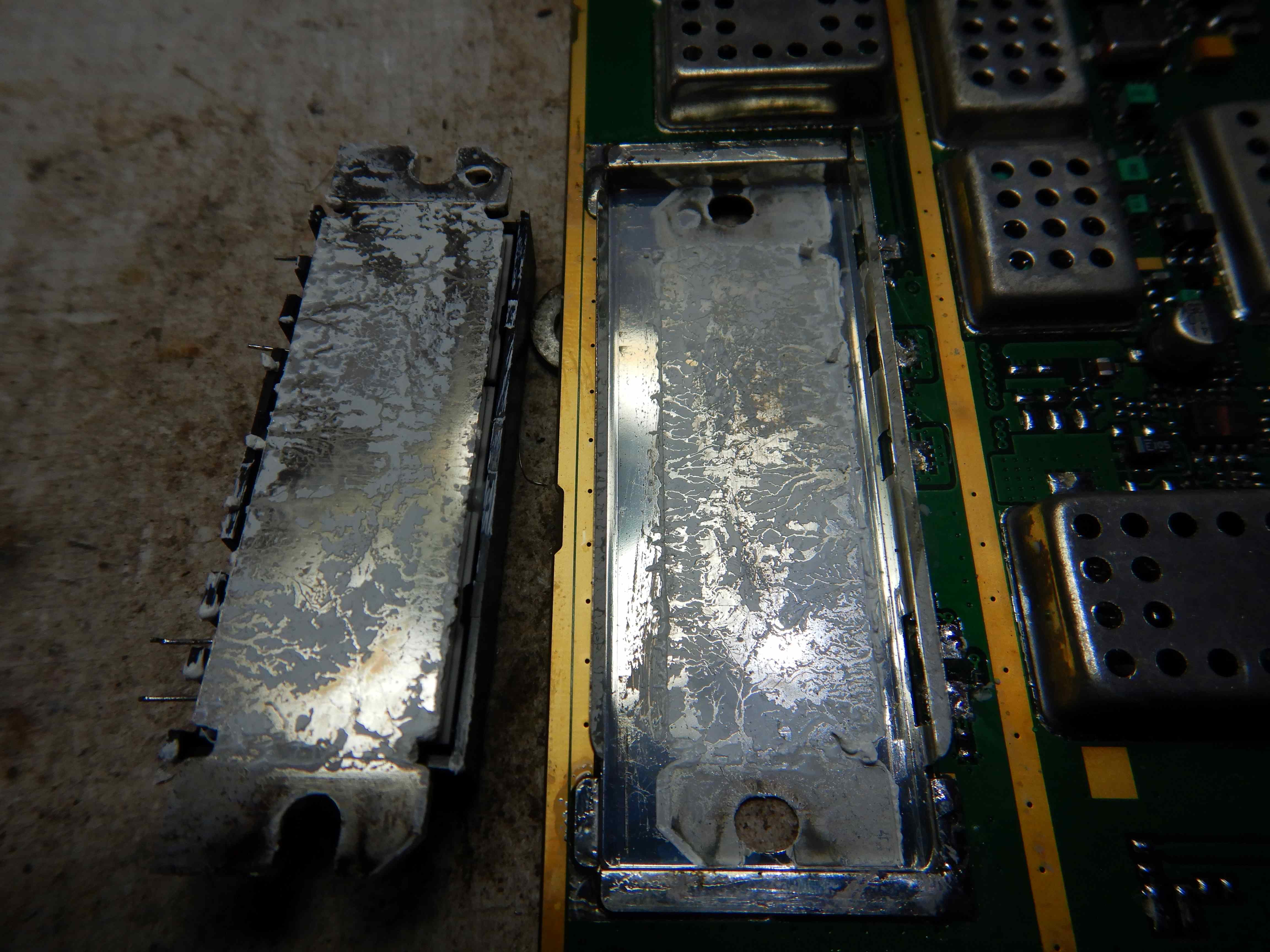

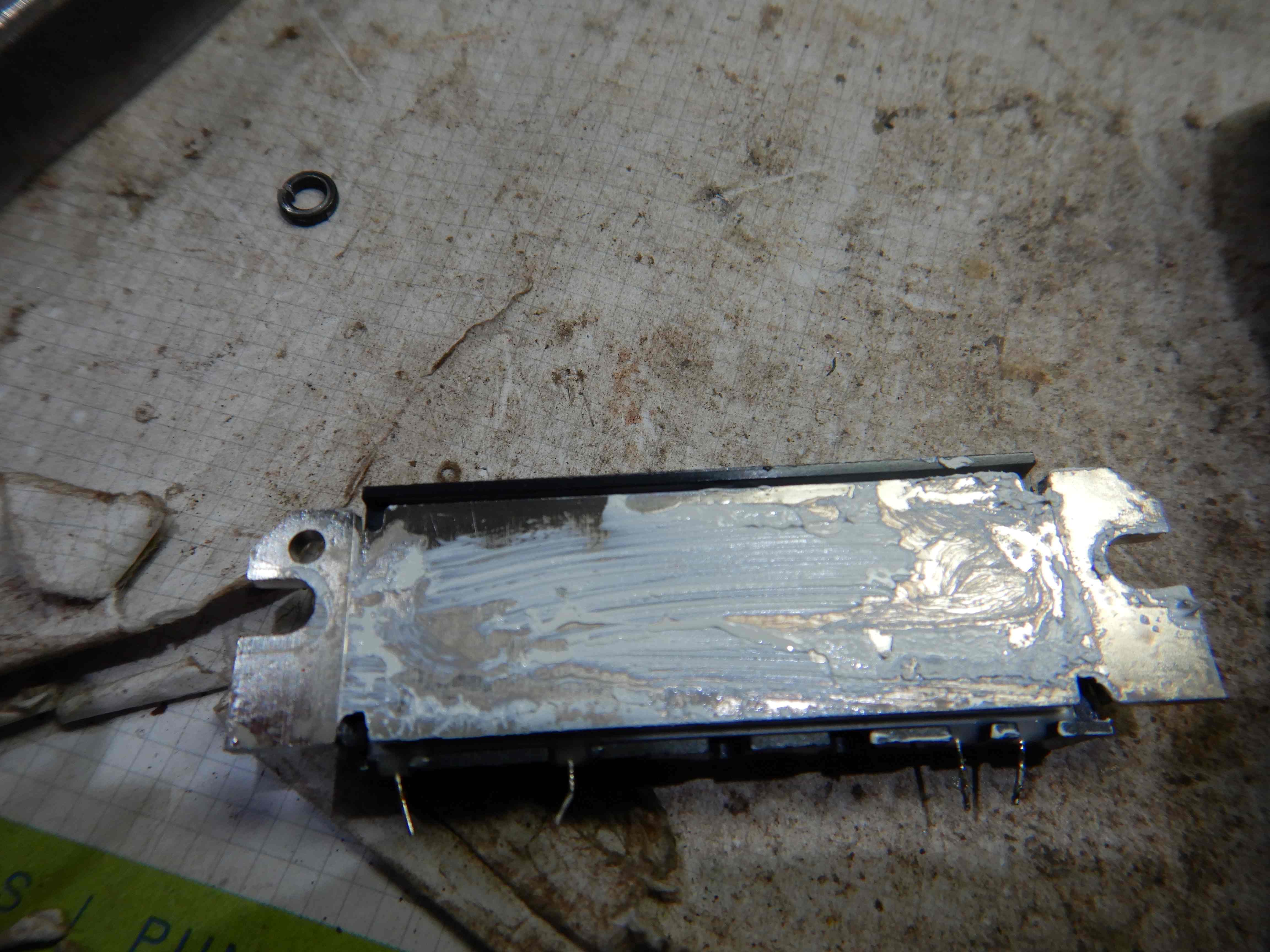

I'm glad you raised the mounting instructions, generally I would agree, but after 20 years of fixing two-way radios I'm synical
The sad reality is the Kenwoods/Simocos/Taits/GMEs with indent modules never look all that great, lucky the modules are tough
The pics are random radios with indent modules, air bubbles, poorly applied compound, solid/dried out compound or way too much
-Not many bother to follow the instructions, even the big brands struggle, so what hope have we got :D
-The quality of the heat sink compound is questionable (the tube we got on special 10 years ago)
-Even good quality heat sink compound is compromised with age and heat, the oil seperates and runs away
-Air bubbles seem to be normal without great care (just like putting a plastic screen on a phone)
I like Dow Corning Heat Sink Compound, but our tube in the workshop, the oil is seperating from the paste in the tube, imagine in 10 years
A larger amount with air gaps on the side of the module with heat from added bias, has more chance to ozze and dry out
LDMOS uses no such indent, so I doubt this practice has much scientific backing, just two flat surfaces with a smear of compound
Personally I use a pallet knife or scrapper to apply a thin consistant coating to both surfaces, depress one side first, slight rotating motion
Less is more in my humble view Roger VK5YYY

Hi Roger,
Well, it sounds like you have vastly more experience than me with these devices (and in general). I sifted through as many references as I could find before embarking on construction. The consistent message was that these devices get hot and that managing temperature rise is vital. I have been surprised by how inefficient the modules are when biased at 5V for class A. My 60W UHF module draws over 12Amps. The 23cms, 18W module, whilst drawing less current, is even worse. With my mounting method, at full output, the VHF/UHF modules don't get hotter than 30 C. The 23cms stays at about 42 C. That is on a smaller heatsink but still with a fan.
As for heatsink compound, I bought a small tube of fancy computer stuff (?? Arctic Silver) for the VHF module but used plain old Dow Corning for the UHF and 23 cms modules. I also used a thin layer of Dow Corning between my copper spreader and the aluminium heatsinks. One thing I have noticed is that the heatsinks get hotter than the top of the module cases, which I take to be a good thing.
GM3SEK suggested (having applied compound), "Place the module onto the heatsink so that one long edge touches first, and then lay the module down onto the heatsink like closing a book. Hopefully this will avoid any trapped air bubbles. Give the module a small shuffle to help spread the conductive compound and expel any trapped air." That sounded well-considered advice, which I followed.
73, Russ.
