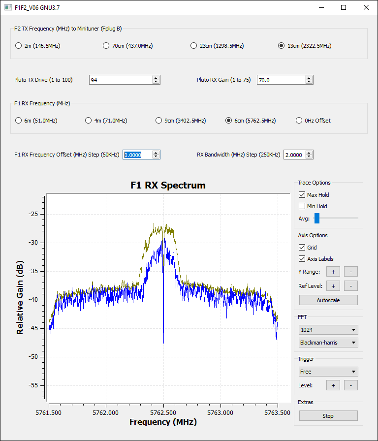

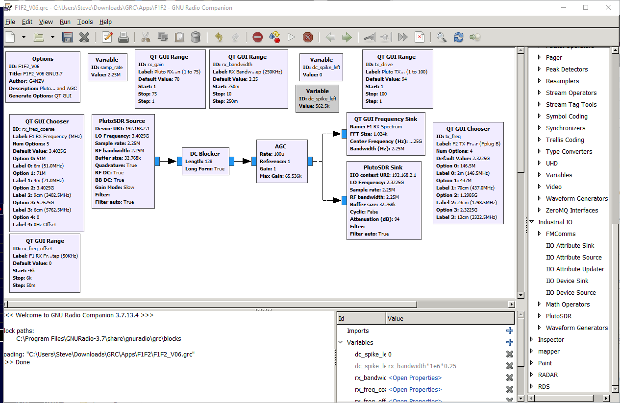

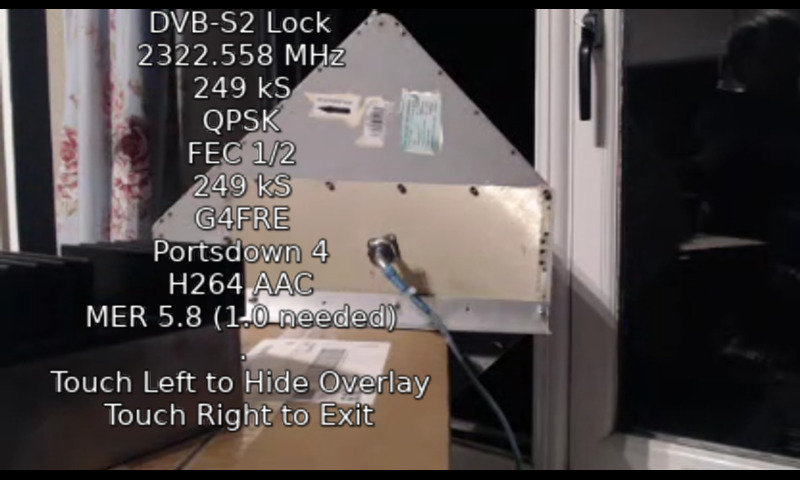

Pluto maybe used as a Digital Frequency Converter to move a chunk of spectrum up to ~2.5MHz bandwidth from one band to another. This example shows reception of a 8Degree sidelobe of a 6cm DATV DVBS2 transmission from G4FRE over a 17.5Km path between Malvern and Tewkesbury using a Portsdown4 and Minituner tuned to ~2322.5MHz.
The technique of shifting chunks of spectrum is very useful as it opens up possibilities of DATV reception on frequencies outside the tuning range of the Serit tuners used in various projects.
Degradation of signal was crudely assessed by converting the QO-100 beacon IF from a non-locked LNB at ~742MHz to 2322.5MHz improving the MER by ~0.4dB.
The GUI shows the spectrum display of G4FRE's 5762.5MHz signal, blue line is the live spectrum, green line is with the maximum hold function enabled. (This is very useful in peaking the dish as the 'best' can be easily observed). If '0Hz offset' is selected a receive frequency can be directly entered otherwise it serves as an offset for fine tuning.

I used GRC v3.7 with gr-iio blocks on a i5 windows10 PC
