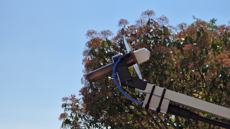

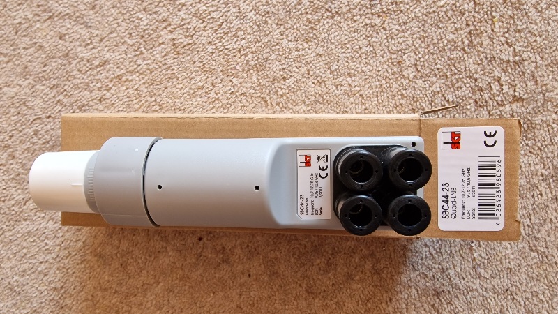

Hi Dave.
Yes, people also buy the rocket lnb and take the lens off and use on poty.
- 20230610_132140.jpg (184.22 KiB) Viewed 11693 times
- 20230613_155051.jpg (134.04 KiB) Viewed 11693 times
