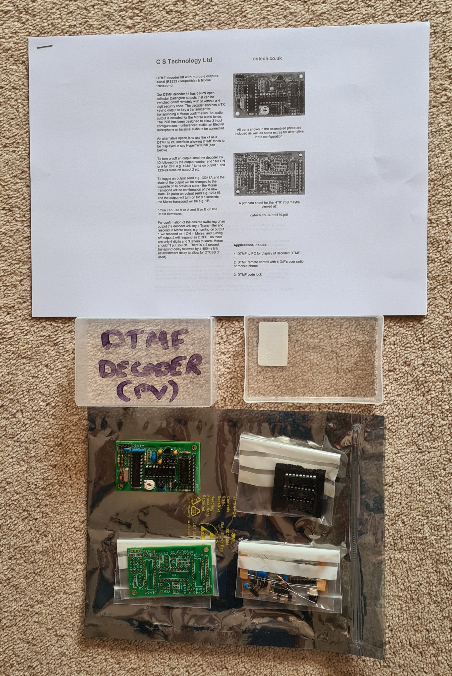

Just seen your call out for a DTMF decoder, I have a little built pcb and a spare kit that was used on GB3PV, are you interested in both or one built/kit.

- E5673E37-C4E1-4D80-BEFA-2531A72FAAAE.jpeg (1.5 MiB) Viewed 4875 times

Brian,
Thanks for the offer but I think we're sorted now.

Brian,
