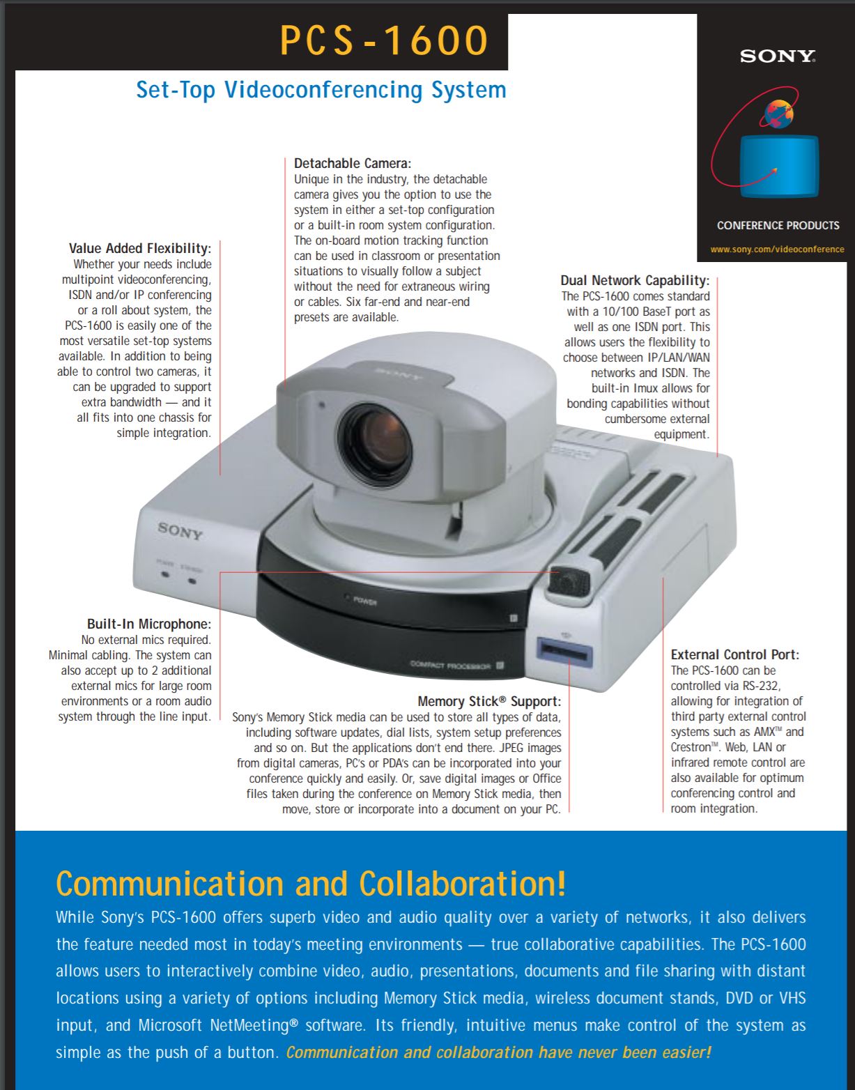

There are currently many ex-video-conference cameras appearing on auction sites as corporate systems are upgraded from cabled analogue video cameras to IP cameras connected via PoE. Sometimes they come with a base unit, sometimes not. The base unit may be useful but often it is not well suited to amateur TV use. In most cases the camera and base are designed to be separable to facilitate installation. That means all we need to do to use just the camera is build an interface.
The video output and DC input are available on the connectors. Most seem to be 12V and S-Video or component video. What about the pan/tilt/zoom/focus/iris?
Thanks to Noel G8GTZ for pointing out the Sony PCS1600 video conference system cameras use a standard VISCA protocol.
Following that tip, 5 minutes in Google revealed a Sony installation manual that helpfully details the connector pinout and the protocol which is actually just packetized data sent via RS232. Google also came up with software implementation libraries and both free and paid for applications implementing the VISCA standard and others.
Connections
They Sony system I have uses a 15 way DB15 connector - that's the one with two rows, not the VGA version.
All that needs to be done on the hardware side is to make up connectors for power, video and RS232. You need a Female DB15, a Female DB9 and connectors for S-video and power. I used a standard 4 pin S-video connector and DC jack. Here are the connections:

There are 5 ground pins (5, 6, 11, 14, 15) which are all connected together. The same with the two 12V pins (9, 10). I only wired one 12V and power ground. I used pin 5 for S-video cable screen and pin 6 for RS232 ground as that kept the cable bunches together.
I am using an Easycap to capture the S-video. With the above connection you should get video out of it. Note it is a 12V supply, not a 13.8V supply. Some people forget. It will probably be OK, but why risk it.
