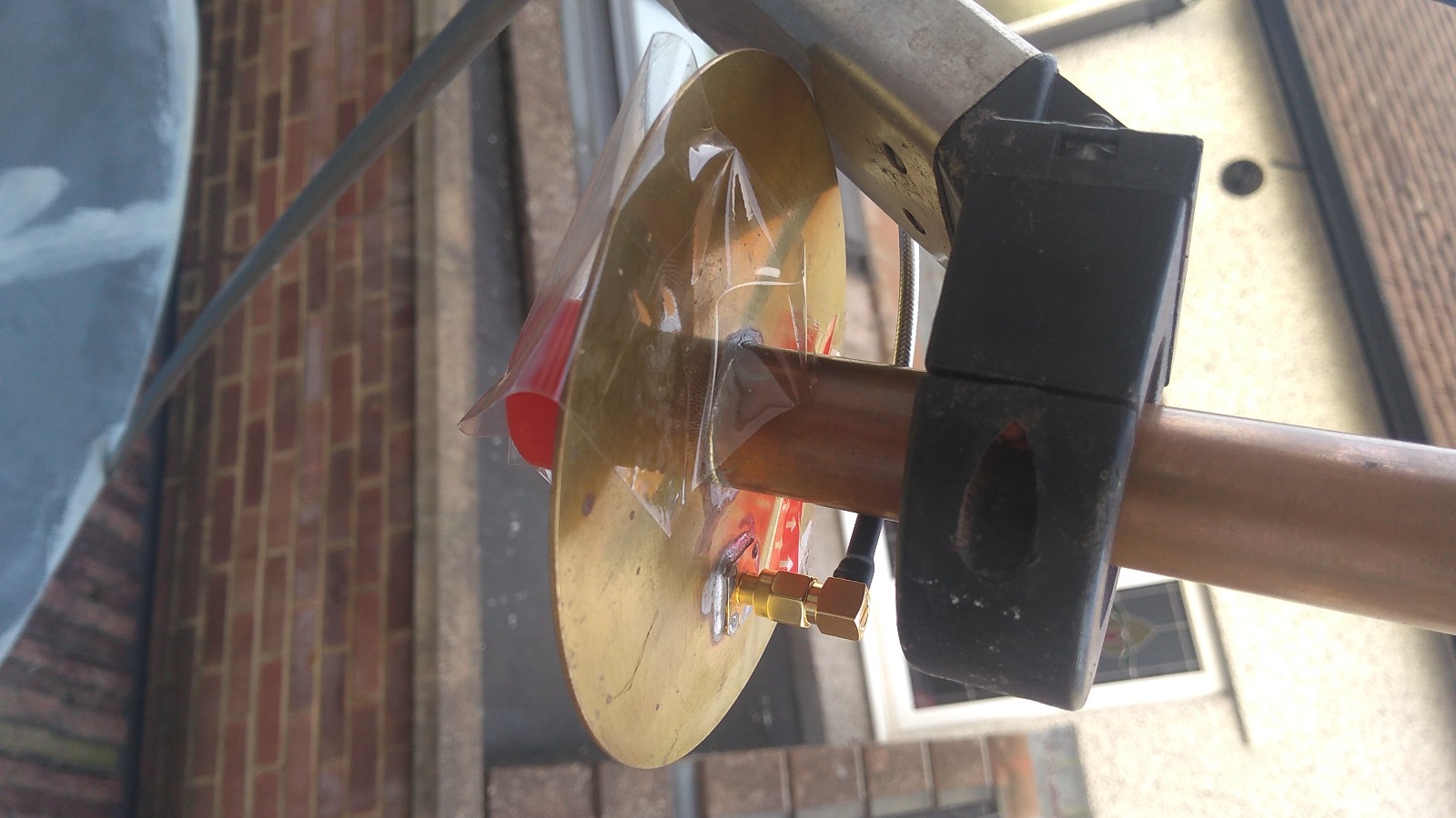

I want to make another, or modify my existing POTY antenna to use an N type connector rather than the existing SMA. Is the location of the connector on the discs important please? Thanks.

Not just important, CRITICAL I'd say.

Thanks, it's times like this 137kHz LF looks good again! I have found an Amphenol long body, right angle PCB mount N type jack that might squueze in to my set up, Digikey have them, so if I remove the SMA and solder up the 2 screw holes, drill the centre pin hole out a tad, and solder on the N type keeping the centre pin hole in the same place as the original SMA hole centre, I should be OK? Thanks a lot!

Yes that should be ok, you may need a spacer if any of the connector body protrudes into the gap between the plates, that's a definite no-no.
Edit; looking at the link, I think the centre pin will need extending as the body will need spacing to allow fitting the plug.

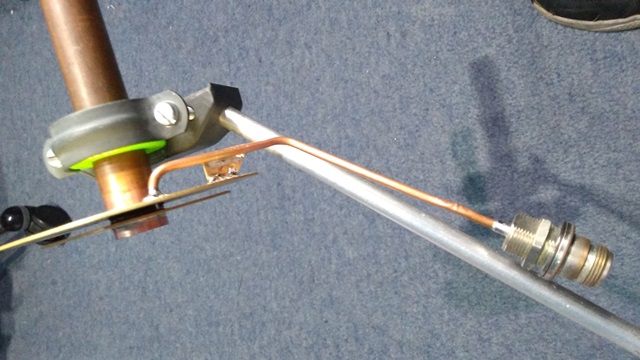

Gareth has a much better solution to that. Eliminate the connector on the POTY itself. Instead use a piece of semi-rigid or semi-flex, one end with a connector on it, the other end prepare the cable to solder it directly to the plates. This takes up a lot less space.

I used a 'surplus' SMA to N-Type panel mount and just removed the SMA. With a temp '8' chisel bit in my 50W weller iron, I was able to solder the outer to the back disc and the inner similarly to the square element. I made a mount to attach the N-Type to one of the dish LNB support arms. My thinking was 'one connector less' and no adaptor as able to go directly to 4-500 feeder cable.
Mounting of the N-type will need to be dreamt up to suit your own dish. The larger photo shows what I had before, so I've lost one connector and reduced the small hard-line to 1/10 of the original length.

The power should be OK if you use the right semi-rigid. The thicker stuff is not very flexible though. RG402 should handle 200W at 2.4 GHz but don't exceed the 1/2" minimum bend radius. RG405 it thinner but won't handle more than 50W.

Thanks, that does look neat and lower loss than 90 degree connectors!
