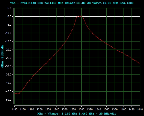

And of course deeper googling and a rummage in the junk box/memory box produced a device labelled "G3GRO/1290" (Ex Crawley ARC and silent key 2016). Part of a big box full of stuff purchased at CATS 2018, it looks like a 3 pole interdigital, BNC in and out.
A quick run up on Satsagen shows a response curve every bit as sweet at the one on the BATC 24cms Filters page.
Question of power handling remains, what determines the rating??

Post by radiogareth » Sat May 22, 2021 10:53 am
Thanks Clive, This one does look 'home made' but very well home made and silver plated too.
Here is a satsagen plot of its characteristics. 'Good to go' I think.
Rather nice that I have another two of them so I can adjust for NB and perhaps use as RX filters too with a bit of gain.
