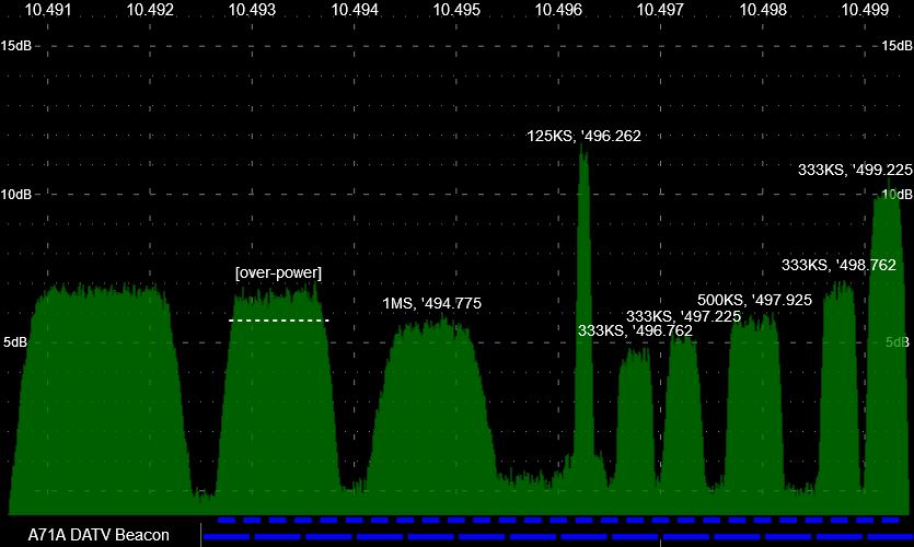

Post by g8gtz » Tue Nov 10, 2020 6:11 pm
Thanks for the responses.
I've been monitoring the MER using the Portsdown large screen readout and seen a variation of 3dB between 10db on an empty transponder and 7dB with the useage below!
A single large signal can drop the MER by 1 dB - something to be aware of when tweaking your dish!
