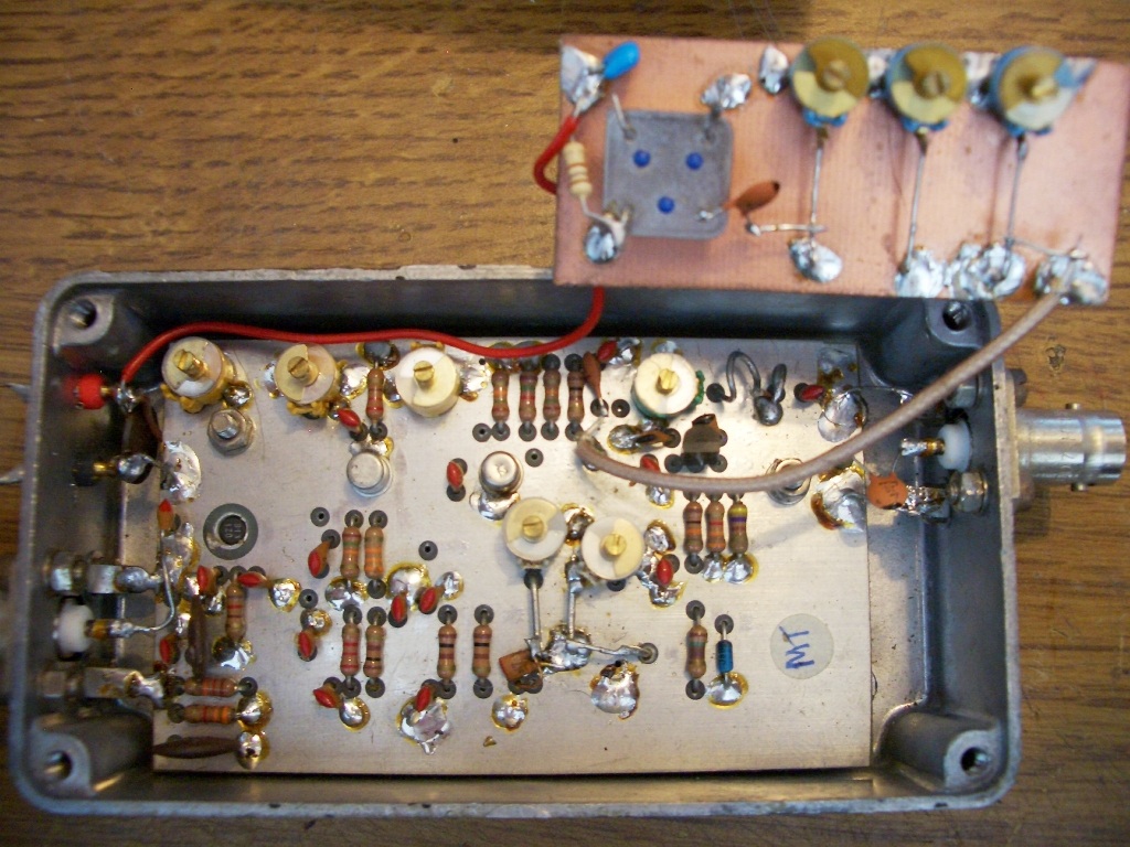

Hi Ian, yes i did this some time back but never really used it after Finding the directv converters..
See attached image for my crude solution:
Oscillator is 125MHz TTL module on 5th Harmonic with output filter tuned at 625MHz, this replaces the original oscillator circuit.
Te two tuned lines are around 1/3 of original length and tuned up for 1062MHz.
Not sure of the conversion gain now as i have never tried it in anger!

Many thanks Rob I'll give that a go. Cheers. Ian.
