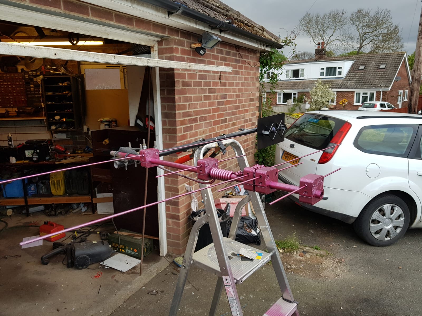

cant receive EY from here even on a 23 ele tonna and preamp. I have two 1-meter dishes up for oscar 100
2m+70cm+23cm and 2.4 ghz beams up

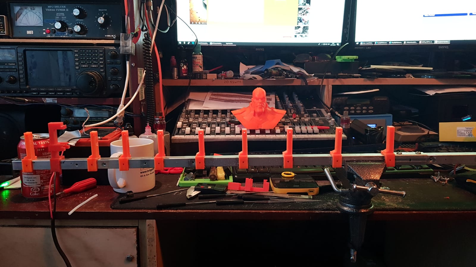

have one mini-tioune up and running building another to go with the portsdown Im building
busy 3d printing parts for antennas for portable use, 2,70,23 bands
also uplink for oscar 100
https://www.thingiverse.com/thing:3903285
and another tonna this one 18 elements
excuse the mess Im messy when building stuff

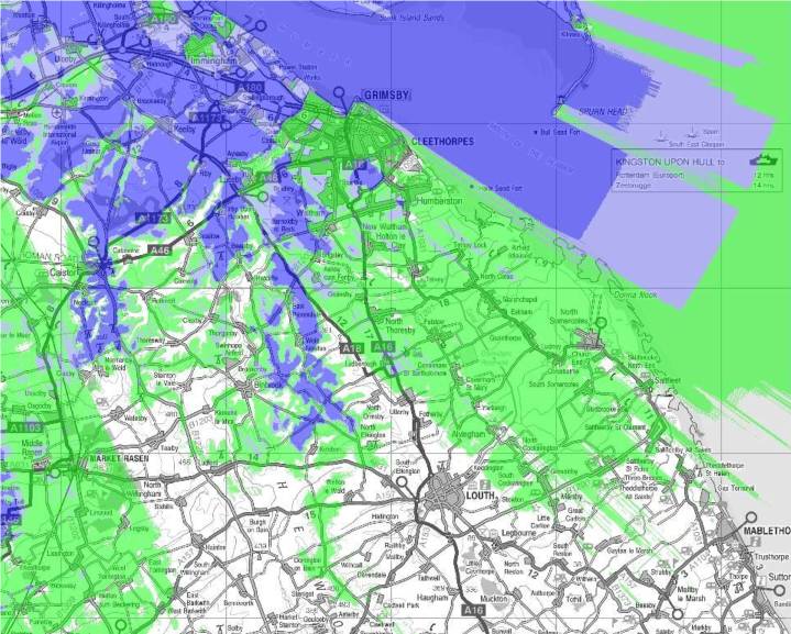

I am doing most of the engineering on GB3EY and I'm based just to the west of Hull at Anlaby Common. I’ve just seen your post on the forum.
You should be able to receive EY; the attached archive is the web output from RadioMobile Online showing the path to you QTH. With a 16dBi gain antenna at 6m you should be getting at least 9 microvolts into a preamp. That from our experiments is enough. The repeater has been seen at Royd Moor 79km from EY. I’ve also attached the predicted coverage from the ukrepeater.net site for your area.
