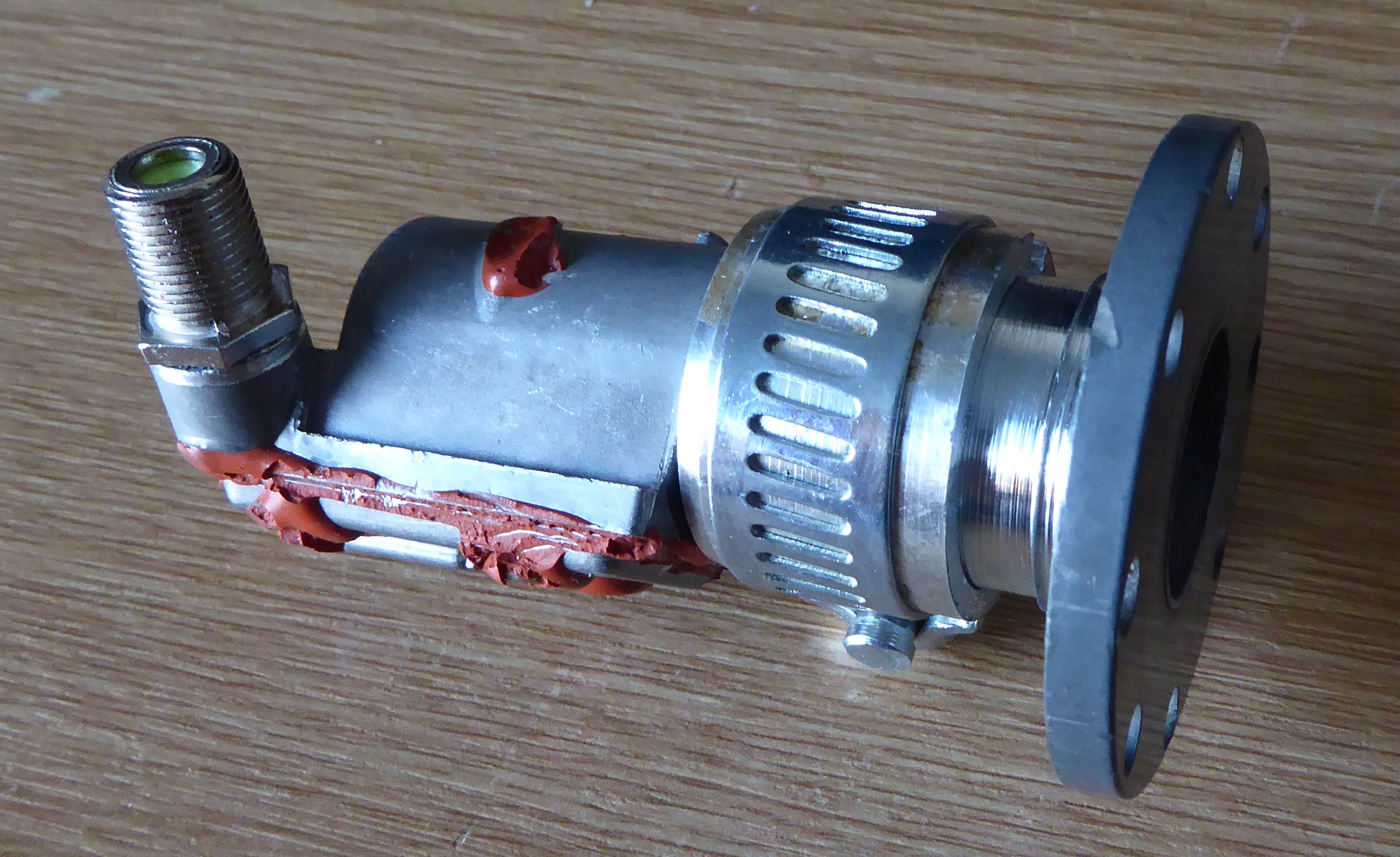

I do not know of any C125 PLL LNBs. I have a C120 channel master horn on my 1.2m dish.
I used an octagon and a surplus c120 horn. I cut the horn off the octagon and the flange off the old horn. Joined the LNB and Flange.

Ah, I was hoping there'd be a PLL version, not sure my metalwork skills are up to your solution.

Metalwork skills? A hacksaw, areldite and a hose clamp for a bit of mechanical reinforcement?

I didn't realise you'd simply glued them together, doesn't sound too difficult then...
