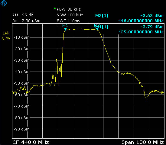

I use this filter for transmission mode after a LimeSDRMini or a Pluto, but not with a MiniTiouner. Its bandwidth is acceptable to filter 437MHz harmonics but not disturbing signals around 437 MHz.

Post by g0mjw » Wed Feb 06, 2019 8:25 am
Hi Jean-Pierre
How does the group delay vary across the bandwidth?

Post by F6DZP » Wed Feb 06, 2019 9:35 am
Interesting question but I have not look at the group delay for this chip, just use it only for low SR and low level. I have not observed any difference with the signal other than 2dB loss, so go further without studying the group delay.
This is a TA1408A
You can find the datasheet here:
https://www.golledge.com/media/2551/mp04694.pdf
