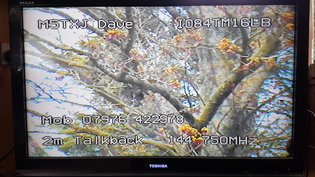

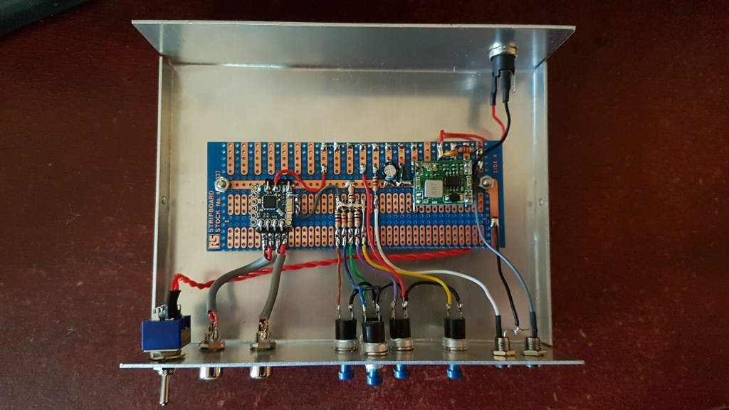

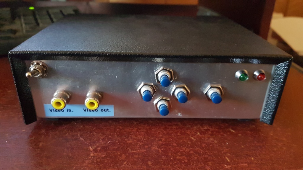

Re: On Screen Display
Well my micro minim osd unit is finished and I'm very pleased with the results. It's a very flexible little unit that's simple to build.
73 Dave.
73 Dave.

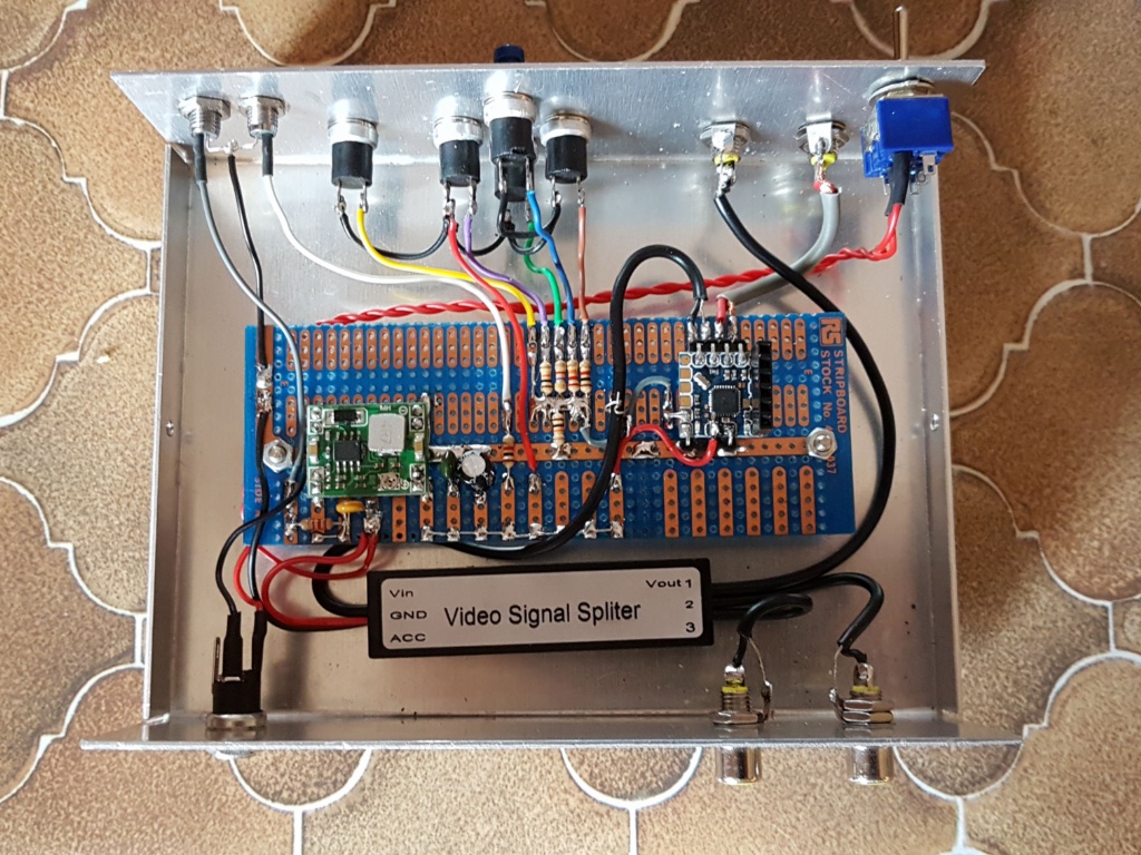

I've now modified my unit, because my Portsdown doesn't show outgoing video when using the composite input you can't see what text you've selected. I've added an eBay 3 way video splitter and extra outputs so I can feed a separate monitor, this works really well. This DATV is quite a learning curve.
73 Dave.
73 Dave.
