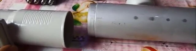

C-band LNB Extention Cantenna / Yagi
While on my quest for C1W-PLL C-band Satellite LNB without dish, I came across this on, I think Brazilian YouTube video.
It's Model No is FH-C63 or maybe FH-C83 snagged from video.
Anyone seen anything like it before, seems popular in South America, difficult to get onto their websites.
Pictures attached...

Looks like a polariser to get from Linear to Circular.
My 23cm EME feed is like the VE4MA feed seen in this link:
http://www.vk3um.com/DUAL%2070%20and%20 ... 0FEEDS.pdf
You can see the 5 posts on opposite sides there too with two probes, one for RH and one for LH circular.
