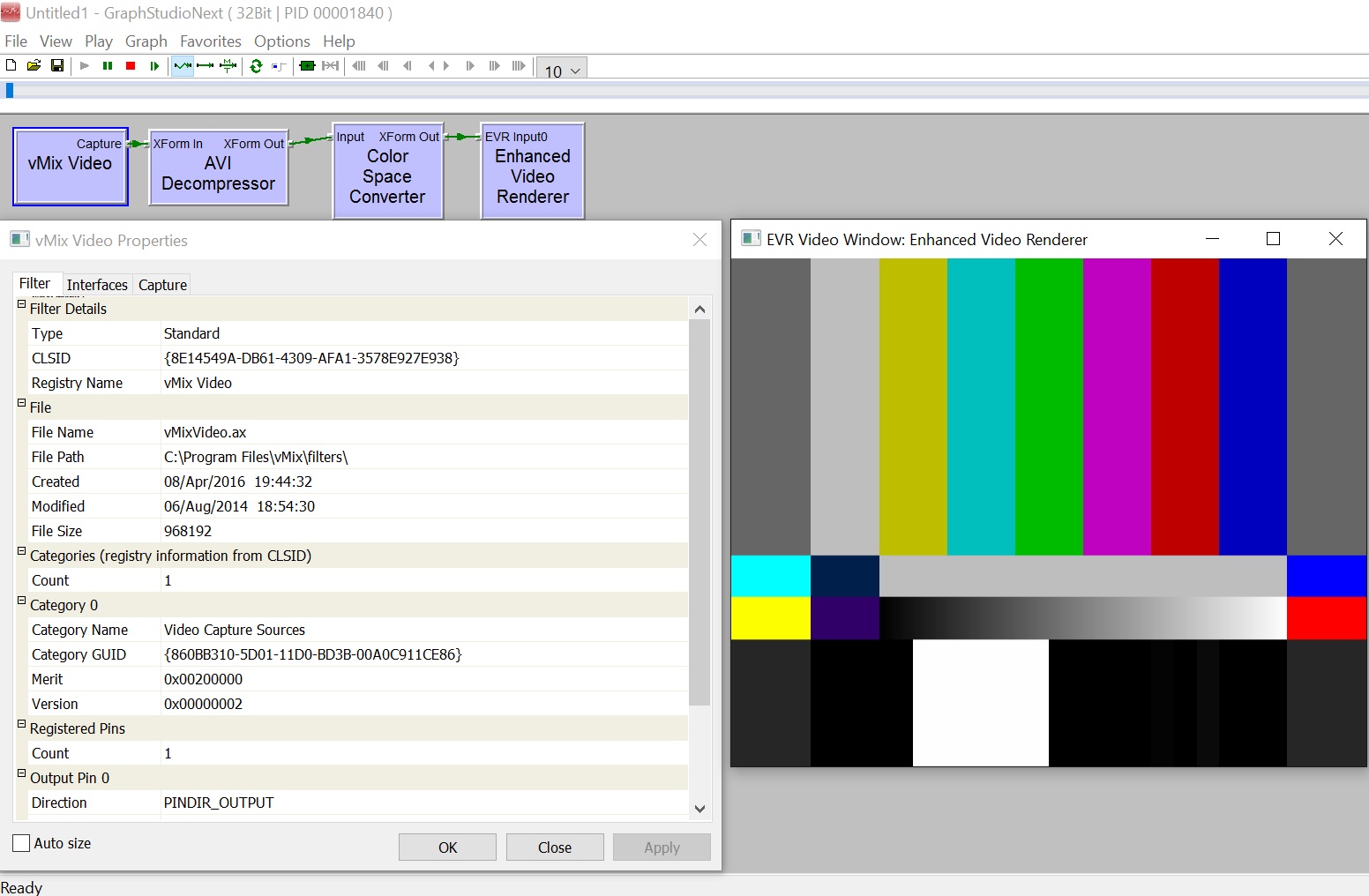

I had just been playing with Process Explorer and found vMixVideo.ax had been called when "Datv Express DVB-S Transmitter" selected Vmix
even when Vmix not running.

vMixVideo.ax being the culprit.
Attached image he sent to me.
