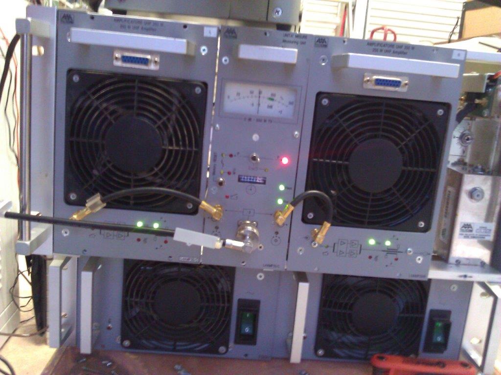

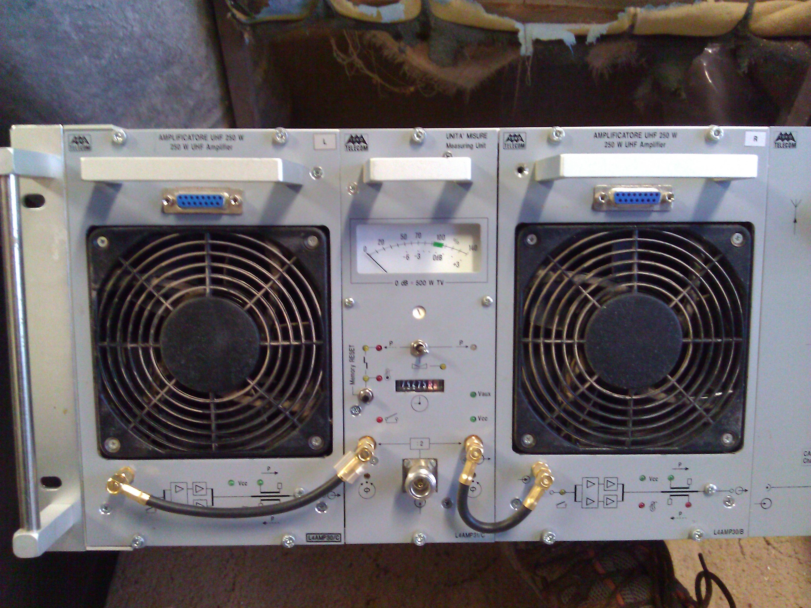

I scored a UHF TV transmitter from a site that was upgraded to digital.
The unit is a 500W Teko on Australian ch 32 circa late 1990 and may be suitable for our local repeater on 446.5Mhz.

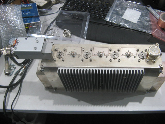

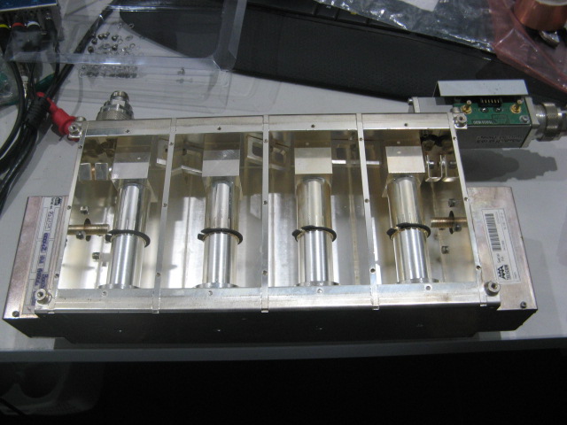

We tuned up the Combline output filter on the PA tonight
The unit was Ch32 AU 594Mhz and it came down to 446.5 no probs
Input loss was 1.3db which is the same as the as found loss (some of which is connectors and cables)
It's the first filter I've seen with a heat sink
All these TV filters have "egg beater" coupling adjustments, more coupling wider band width
There is also 2 pods on each end that look to be notch filters
If someone could explain why, that would be good......intermod?

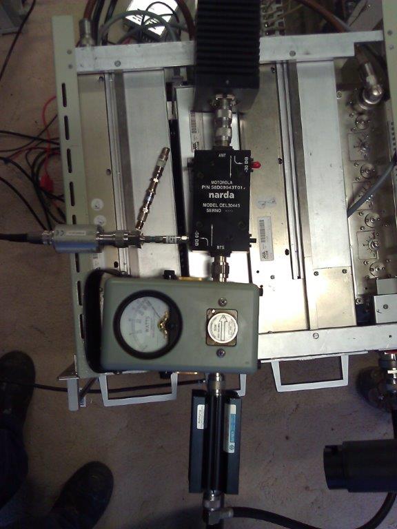

We built a test exciter and that pumps out a watt or two of DVB-T
This consists of a commercial Antiference DVB-T modulator into a HA-40125 Hills (Polytron) 40db MATV Amp, that feeds a 20db ABE push-pull 20W PA
Provided you don't drive things too hard the output is very clean, the Modulator has a MER around 30 which degrades to about 29 through the chain
The key is to drive everything 6-10db below the analogue rating, beyond that spectral regrowth takes over and MER drops rapidly
It's a bit strange having all these very powerful amps in sequence only to generate a small amount of power "MORE IS LESS"
We now have a bolometer style wattmeter (although we found the Bird meter measures within around 2db of the true power)
The Bird meter jumps around but the Bolometer is very stable
TV transmitters have "interlocks" which prevent things working under fault conditions and allow things to power up in a sequence
A nice man at Broadcast Australia told us how the bridge the interlocks so we could power things up
By chance a broken wire was found on the output power measurement coupler so we can now run the whole unit properly
We've tested it to around the 125W it's quite clean

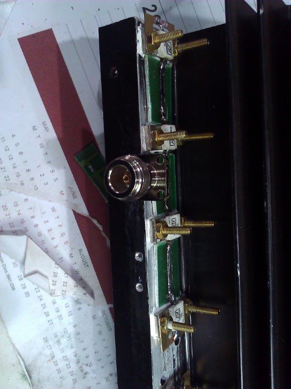

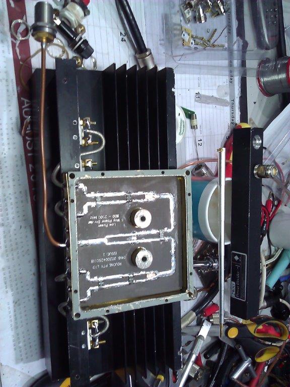

How to build 500W dummy load from RF junk
We now need a decent load to test the PA into so I bought some used 50 Ohm 250W Anaren loads from Ebay they were about $4AUD each (10 buy)
I bolted 8 of them to an old inverter heat sink into 2 groups series/parallel combination to 2 n types the VSWR was shocking

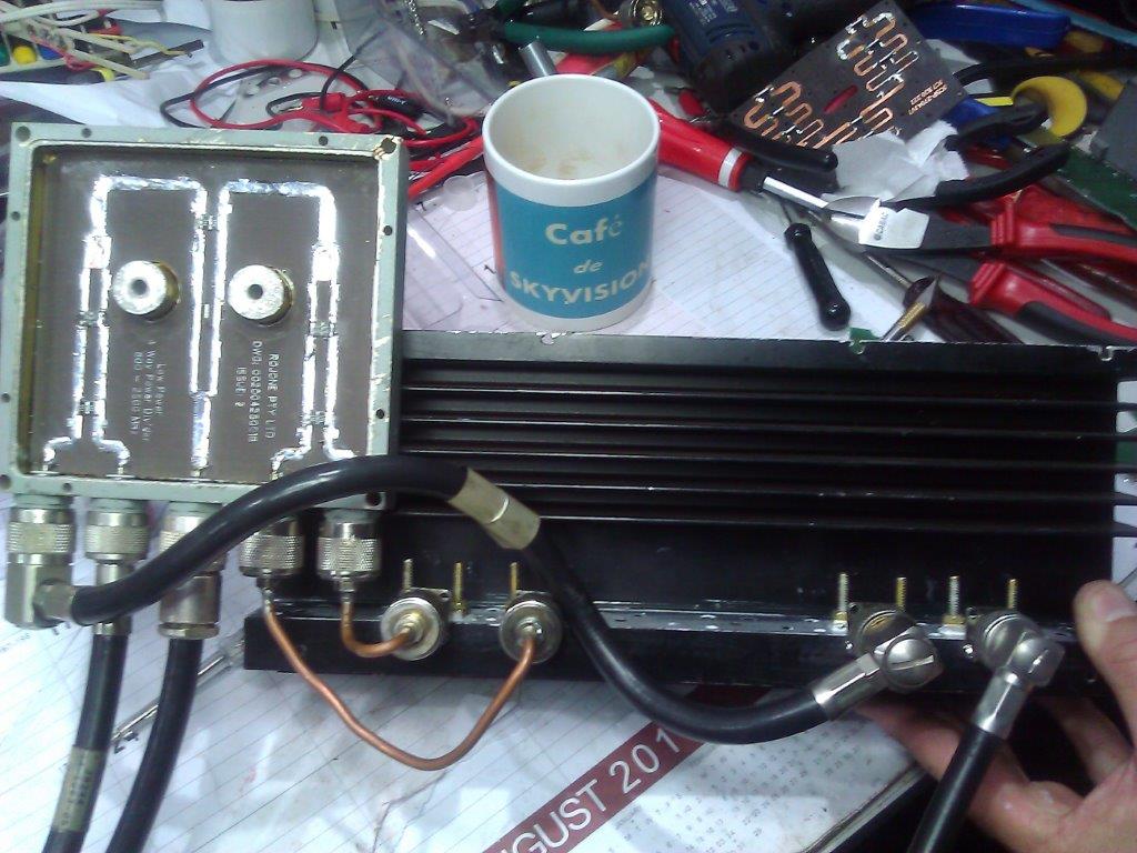

Great idea Danny....whoever listens to radio mechanics anyway

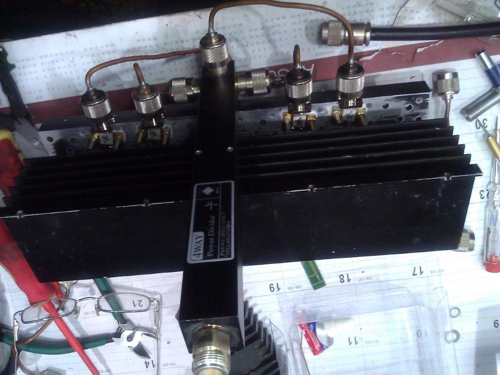

Then I tried 4 individual loads each with it's own n type, I used an old RFI cell phone 4 way power divider to each device the VSWR was much better
but the spitters VSWR went bad at around 600mhz and at 70cms the VSWR was way to high
The power divider is just a lenght of the correct impedance coax that works great at 850-1800mhz but not at 70cms
Then we tried an old Rojone cell phone 4 way strip line wilkinson style power splitter the VSWR was around 1.5 and with jiggling I got it down to 1.1 PERFECT! Only tested it with 25 watts on the bench but looks very promising, testing on PA tomorrow
Tidy up the cables a bit and maybe add a fan for good measure, what's the worst that could happen......Smoke?
- Mk1 load...children don't try this!
- WP_000666 (2).jpg (55.73 KiB) Viewed 10451 times
- Mk3 dummy load sucess at last
- WP_000672 (2).jpg (125.7 KiB) Viewed 10451 times
- Mk 2 dummy load
- WP_000670 (2).jpg (106.22 KiB) Viewed 10451 times
500 Watt PA
We've made the thing a little more compact and have and old aluminium ballast box from a sodium light for a housing
A 240vac Papst fan runs a one end and creates a fairly major draft
Notice the 2 way power splitter in the background does not have parallel inner it's stepped every 40mm,
that's their way of transforming it into a broadband device
- Mk 3 ready to go into the housing
- WP_000678.jpg (85.78 KiB) Viewed 9873 times
