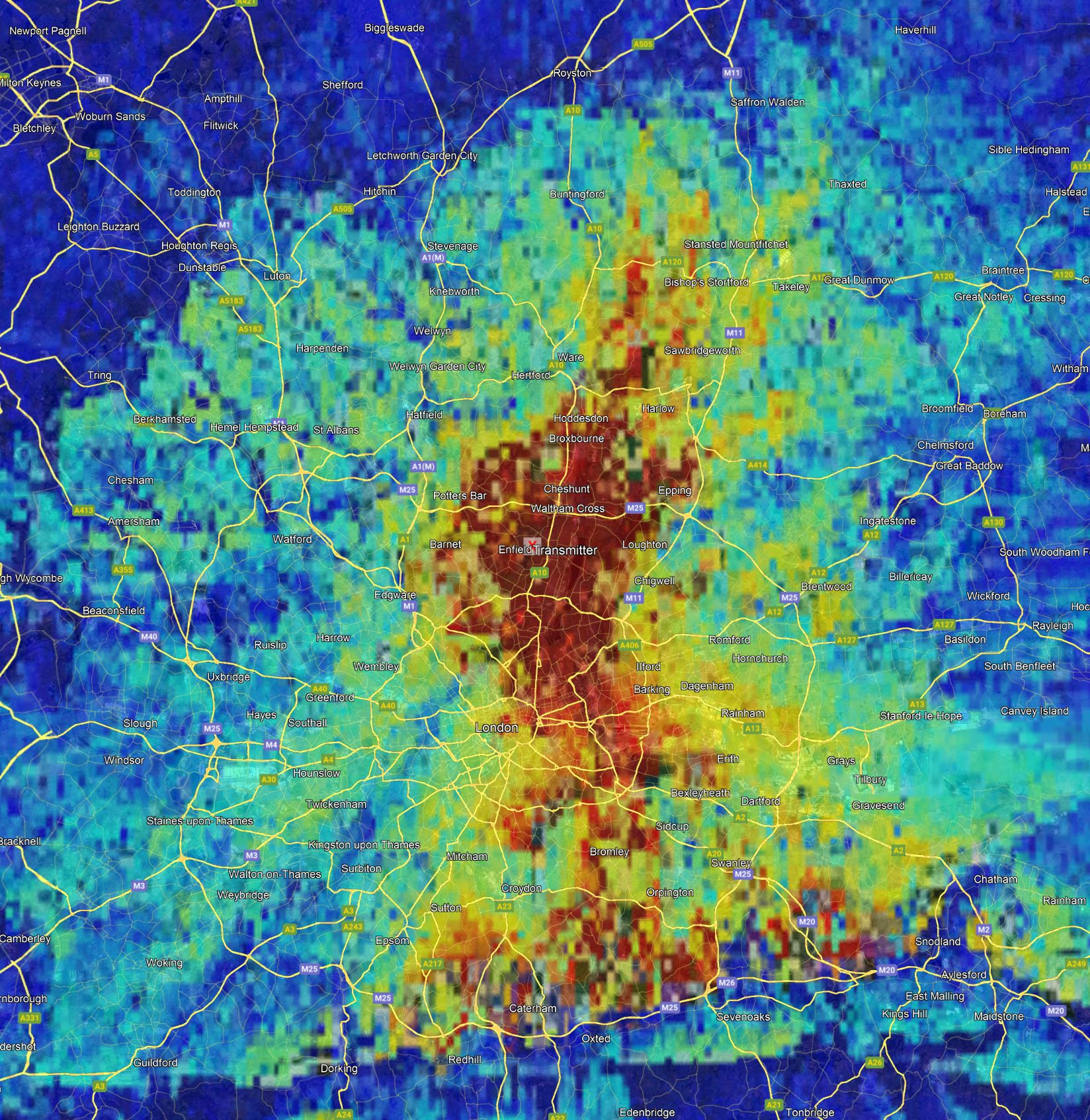

Any chance of a 70cm input? I doubt I can get to it on 23cm.
Do you have an accurate locator and height above the ground? I did a quick 23cm coverage plot based on 10m antenna height. Probably anything out to yellow.

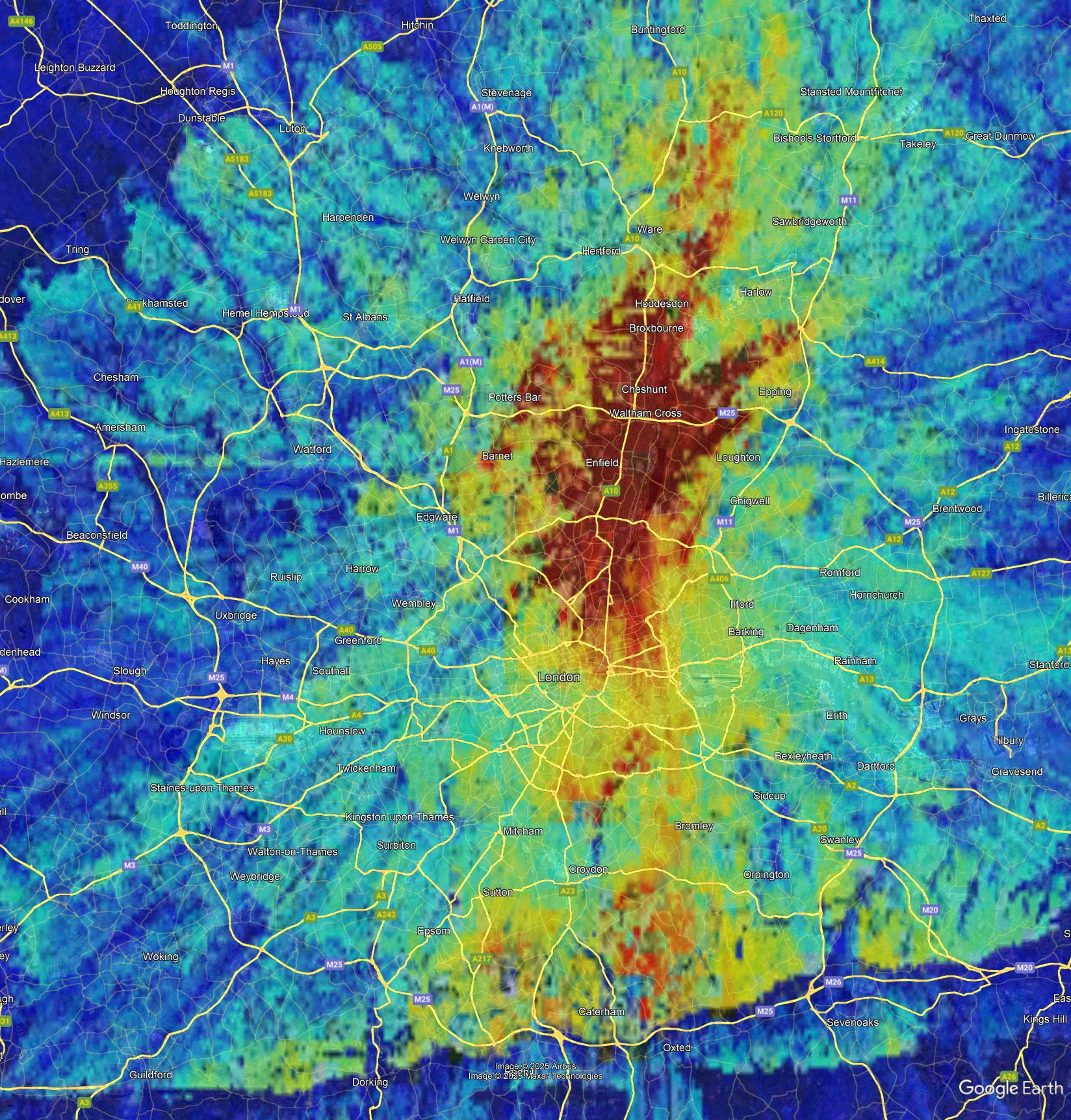

I would think so. Getting in is one thing, receiving it another.
Edit found the locator IO91XP07JE and raised antenna height to 30m.

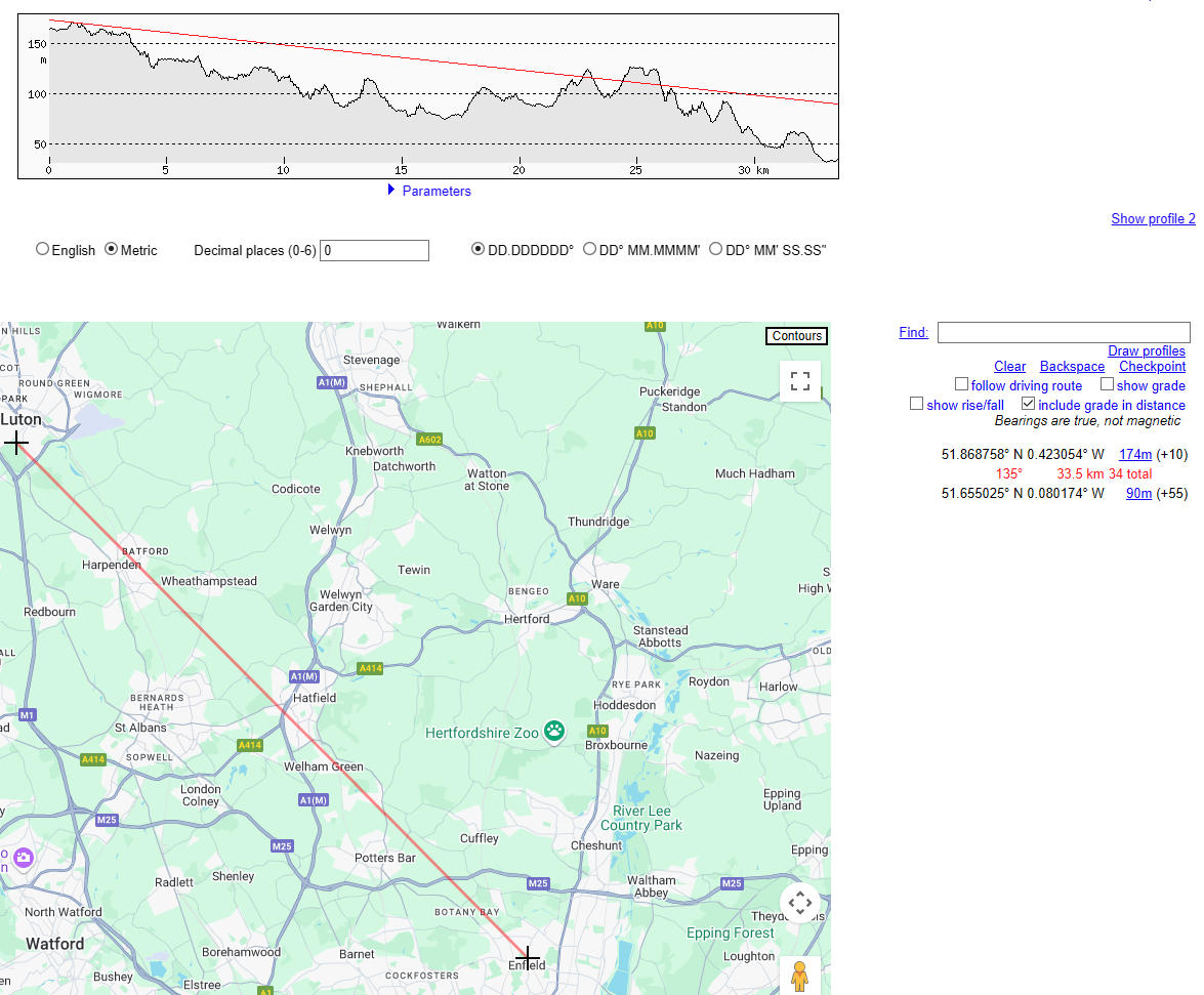

I think it would not be possible from the Dunstable Downs rally, although Stockwood Park is very high, there are some hills in the way but don't let that stop you from trying!
I assumed a 10m mast !
2025-04-25 19_26_34-Start.png (224.59 KiB) Viewed 7599 times
10m mast !

Thanks for the updated map Mike. That looks like too much of a stretch for my location, but I do remember receiving GB3EN in the past (a very long time ago...), so maybe it's still worth a try.
