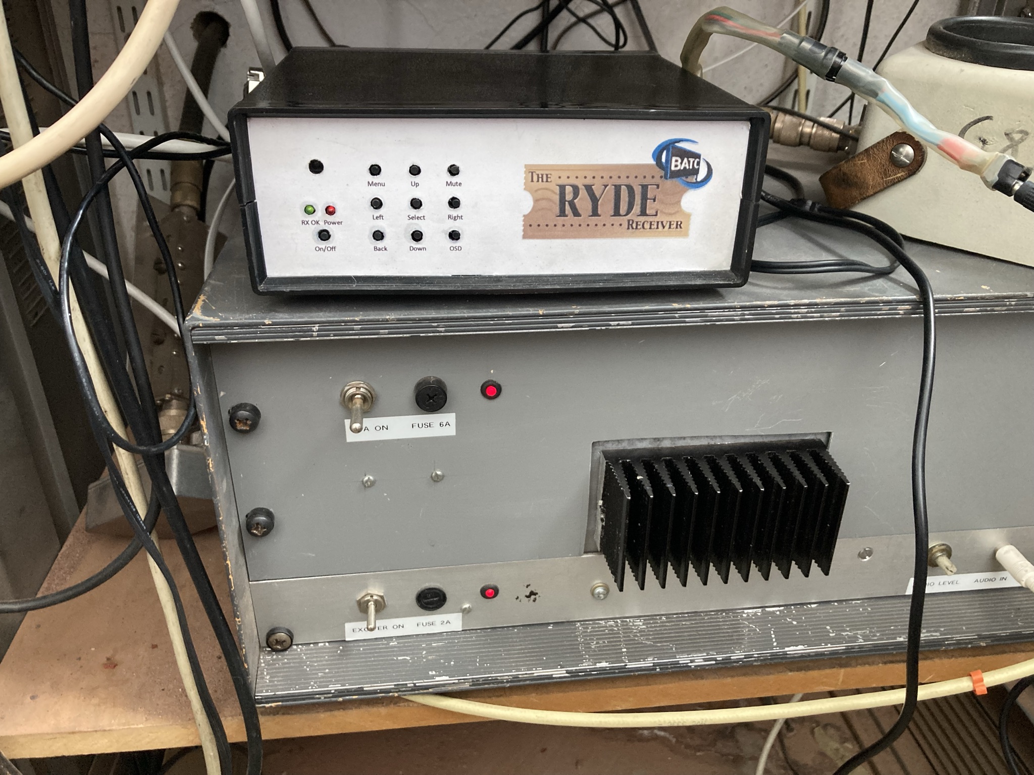

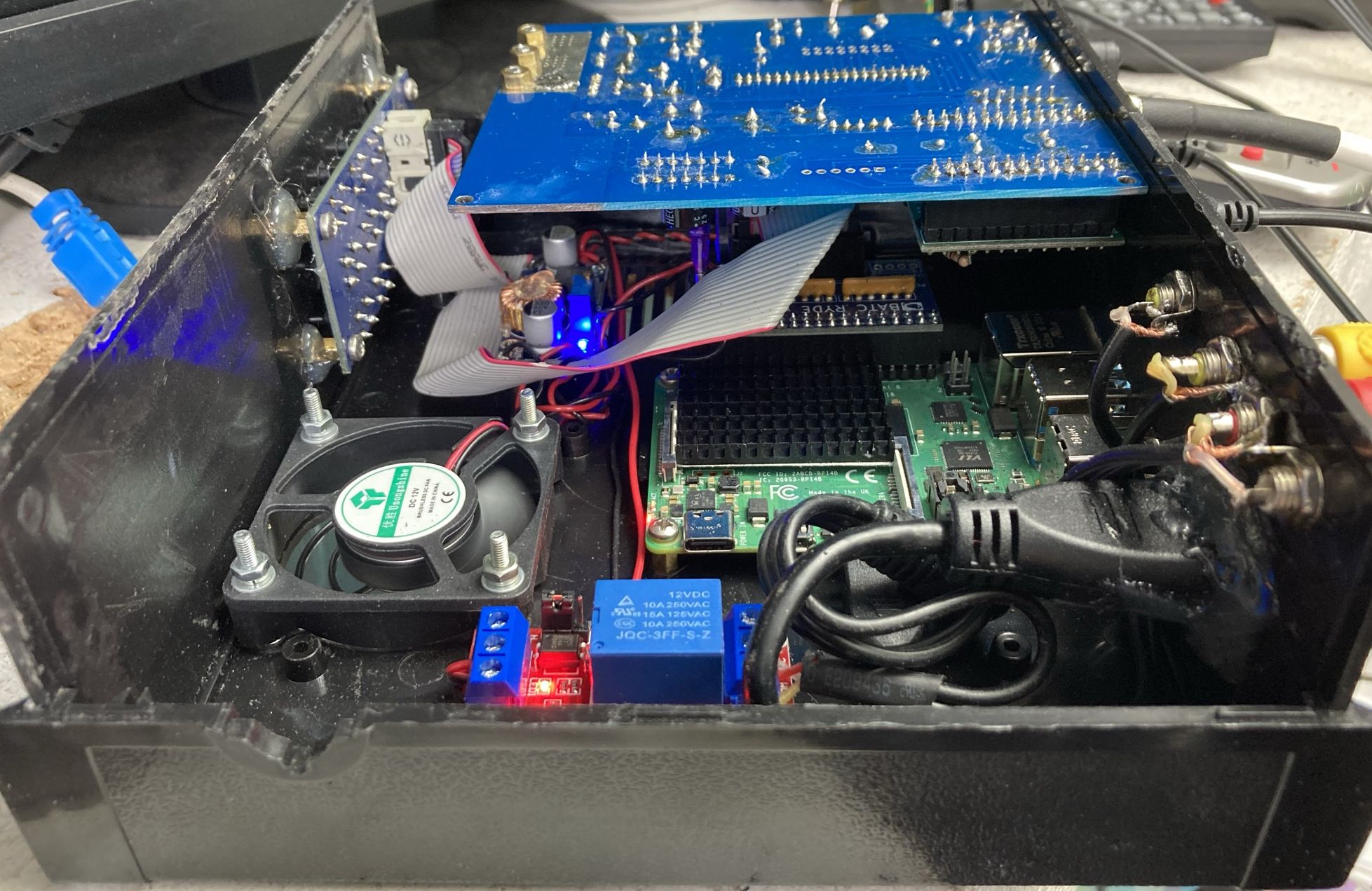

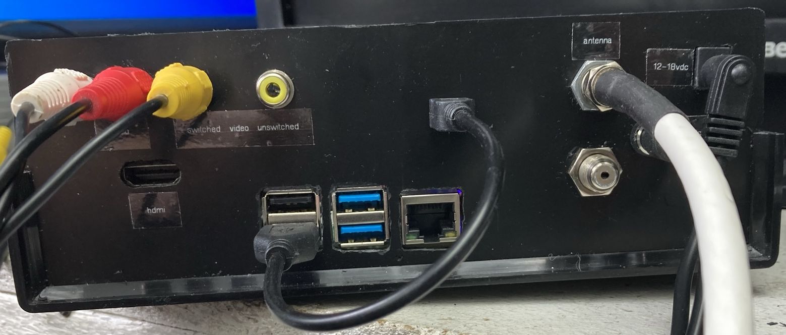

A BATC Ryde DATV RX has been installed at EN.
It can receive the following Symbol rates
333kS/s, 1mS/s, 2mS/s, 4mS/s
and can decoded
MPEG2, H264, H265 with auto FEC
As the Ryde is scanning 4 symbol rates, it may take up to 20 secs to repeat your transmission, please be patient!
The DATV reception suffers some interference from GB3NL 2m repeater transmissions, it will interrupt reception of 1, 2 and 4MS/s with 333kS/s seeming to be less affected. Thankfully GB3NL is not heavily used but it does transmit its call sign every 10 mins.
