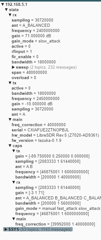

I'm investigating whether I can update the Portsdown to support transmissions from the LibreSDR with tezuka firmware. I seem to have hit a block, but must be doing something wrong:
The LibreSDR is flashed with tezuka-0.1.9; the attached screenshot from the Windows MQTT explorer shows that this is functioning.
state messages.PNG (32.59 KiB) Viewed 2204 times
