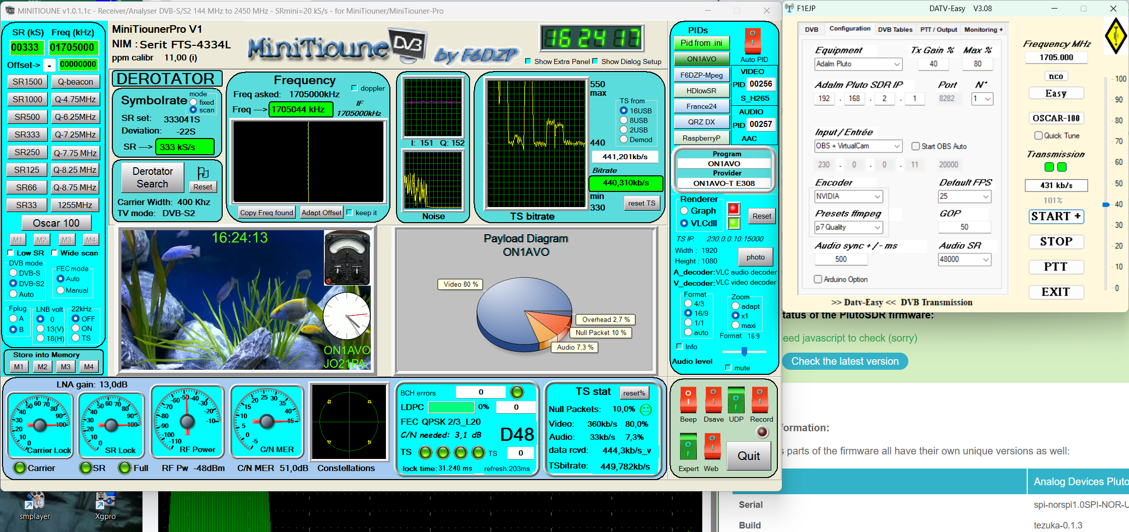

Mauro,

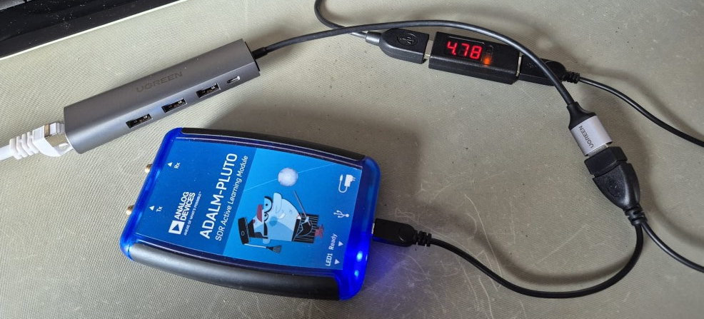

I can confirm that an ethernet connected Pluto, using UGREEN CM266 and Y- USB cable,
with F5OEO plutosdr-fw-0.5.16.7 works fine with DATV-Easy-V3.08.
Follow carefully the instructions on page 5 of the V3.08 Manual and choice of SDR PlutoDVB2 F5OEO (pag.3).
Freddy
ON1AVO

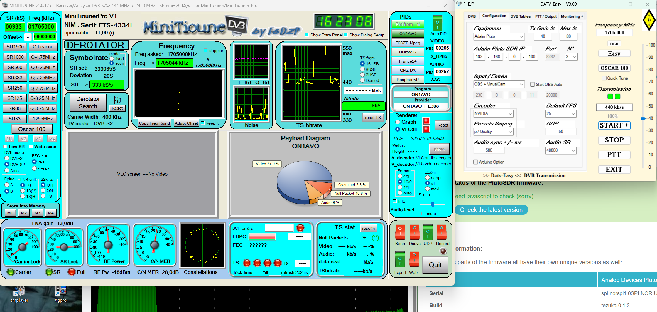

Post by ON1AVO » Fri May 23, 2025 2:32 pm
Test with F5OEO Tezuka 0.1.3 with same DATV-Easy 3.08 settings, except SDR choice :
- Ethernet: not usable, lock/ unlock and so on
- USB: OK
Freddy

I wonder if ethernet not working with Tezuka is due to that ethernet adapter? I have one like that that I use with a laptop and it gets hot, which to me implies it uses a lot of power. It has several USB-3 ports.
That might be why the ethernet is unreliable, even with the Y-cable. I am using an ASUS ethernet only adapter which came with my old laptop successfully, the only proviso being the cable should not be too long, 20m was too long for reliable comms. Same effect.
Different firmware may handle the ethernet adapter differently.

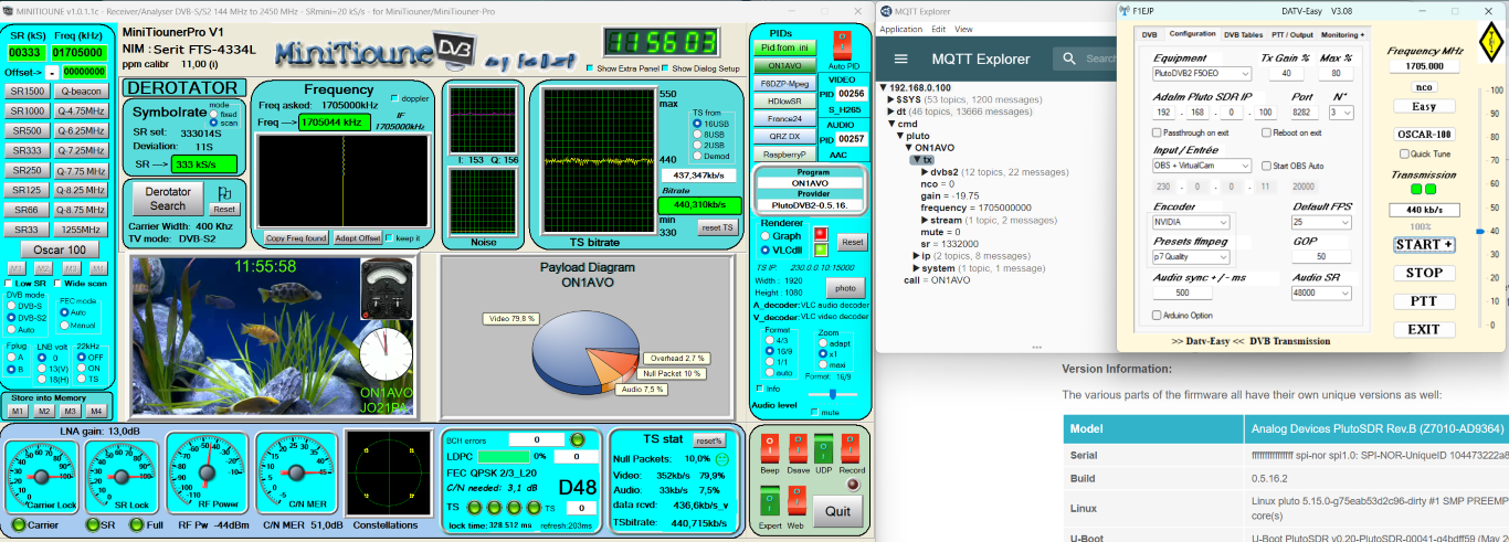

Thanks all for the suggestions! Freddy, finally you pointed me in the right direction... I had setup my callsign initially in DATV-Easy, but it was not set correctly set on the pluto, so after checking it with MQTT Explorer, it works great and the pluto goes tx.
I use exactly the same Ethernet USB adapter, but the power supply is via the separated USB connector, not the Y cable for now.
Now I can start experimenting with this ;)
