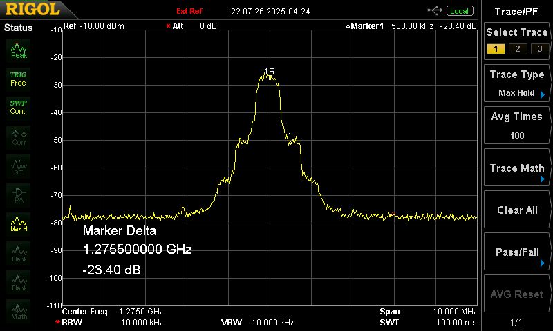

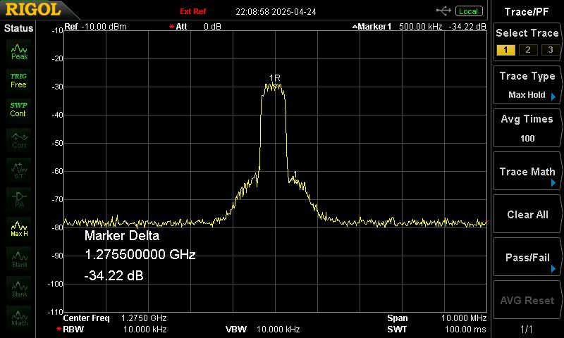

A warning: when using the Pluto SDR, do not transmit with the drive level higher than -33.75dB!!
There's something odd in the level control because increasing the drive from -33.75dB to -30dB causes the output shoulders to jump by 10.8dB. The excessive regrowth might be because the Pluto has hit the threshold of non-linearity or there's something weird going on with the drive level steps. See the SA screenshots below, noting the Delta Marker levels.
-33.75dB Drive Level
-30dB Drive Level
-30dB Drive Level
The performance is likely to be different with other SDRs, but as the Pluto is the cheapest Tx option it is likely to be the most popular.
This is a beta software, so be careful and when using it on air and be patient. A huge amount of work has gone into this, so fixes might take a while.
Clive G3GJA

Hi Clive,
Agree regrowth is normally caused by over driving, if you use a pluto or libresdr to transmit they both do it, think you are seeing that sdr television give a higher level output than obs for a fixed drive level, that is why I have a fixed attenuated output I have never seen it directly from my pluto it maybe a firmware issue on your pluto.
