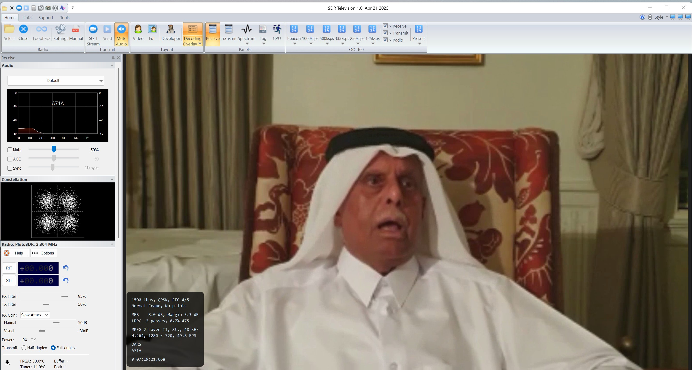

Hi,.
Downloaded an installed SDR Television already had SDR Console 3.4 installed
All looked ok but program wouldn’t start.
Instructions said you must install both kits.
I did this from links provided SDR Television now started.
Install HEVC Video Extensions
Now receive the Beacon
Time to read the manual!
Thanks Simonn G4ELI for all your work!
Martin
G8KOE
PS This is on Win 11 i7 PC

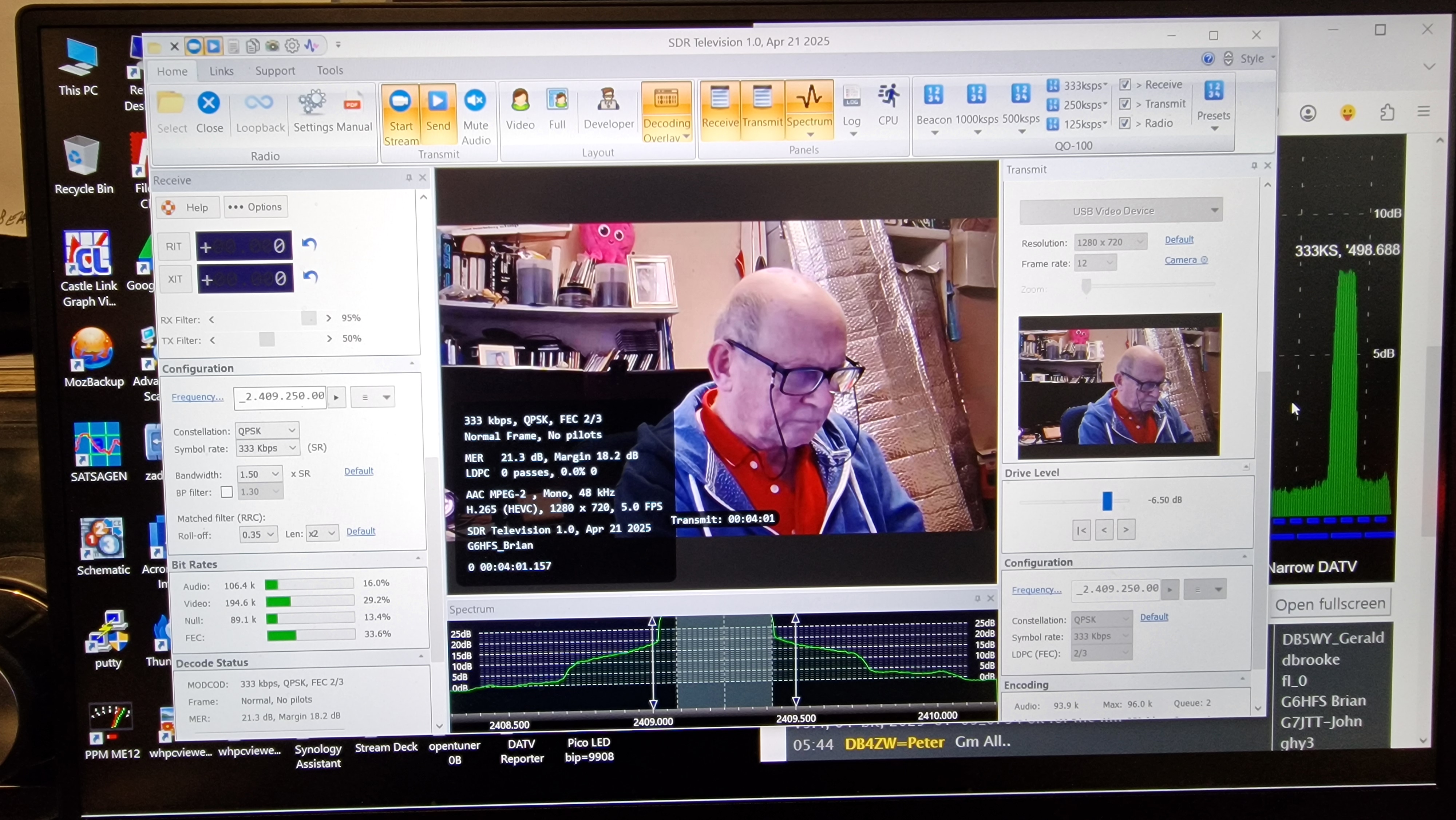

All good here with SDR Television.
- 20250422_072040_Original.jpeg (1.57 MiB) Viewed 10501 times

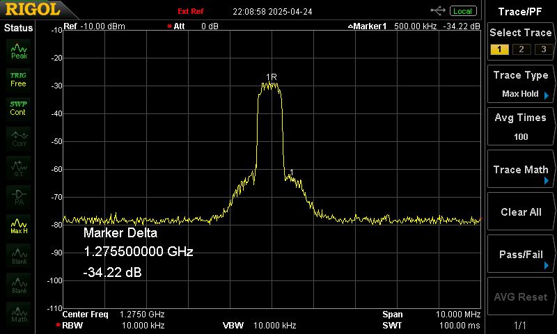

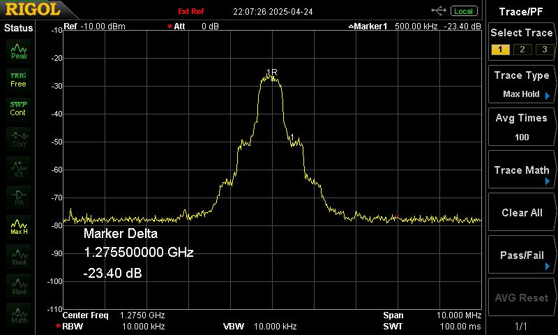

A warning: when using the Pluto SDR, do not transmit with the drive level higher than -33.75dB!!
There's something odd in the level control because increasing the drive from -33.75dB to -30dB causes the output shoulders to jump by 10.8dB. The excessive regrowth might be because the Pluto has hit the threshold of non-linearity or there's something weird going on with the drive level steps. See the SA screenshots below, noting the Delta Marker levels.
The performance is likely to be different with other SDRs, but as the Pluto is the cheapest Tx option it is likely to be the most popular.
This is a beta software, so be careful and when using it on air and be patient. A huge amount of work has gone into this, so fixes might take a while.
Clive G3GJA
Clive G3GJA
Re: SDR Television
Hi Clive,
Agree regrowth is normally caused by over driving, if you use a pluto or libresdr to transmit they both do it, think you are seeing that sdr television give a higher level output than obs for a fixed drive level, that is why I have a fixed attenuated output I have never seen it directly from my pluto it maybe a firmware issue on your pluto.
