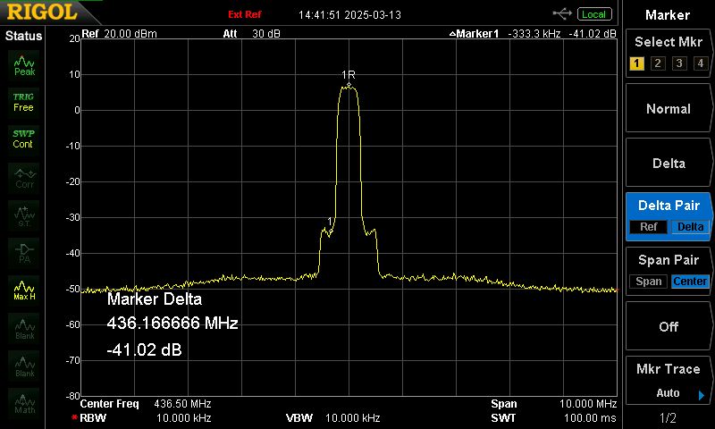

Output at 16W RMS as measured on HP432A with HP487A head; shoulders at -41dB on 333kS/s

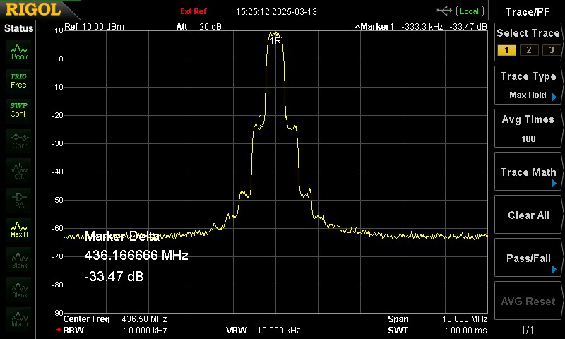

Output at 34W RMS as measured above; shoulders at -32dB. Both driven by the Lime Mini and a SPF5189Z buffer amplifier module from Amazon. Note how the noise floor of the Lime shows as a 10dB hump around the centre frequency.

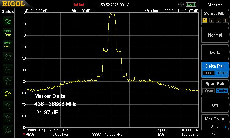

Exactly the same conditions as above, but this time using the Pluto instead of the Lime. Note the absence of raised noise floor and the 1.5dB better shoulders.
Based on this performance, 30W RMS of DATV is easily achieved with the RA604047M1 module. That's why I ditched a Nokia TTRX amplifier that needed a 28v supply and 170W DC in to produce 45W of RF with the same shoulders. No contest!

As I was challenged, I had better explain. The power depends on what level of shoulders are considered acceptable, e.g. -30 dB, -40dB, -50dB. The consensus seemed to be around -40 dB or better on 70cm. Shoulders of -30dB, 20dB and even worse we sometimes see on QO-100 are certainly not acceptable. Hence my 10W limit.
Individual modules may and probably do vary, I could only get 10W before shoulders went above -40 dB. Clive got 16W. My bias was around 5A standing current for best linearity. However, you can tune that a bit. It is not efficient and needs good cooling.
