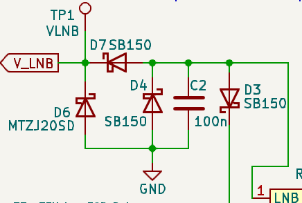

I thought I would add why back feeding the LNB supply is not a good idea. Theoretically, at first glance it should not matter. That's true, mostly.

Imagine if the LNB supply is off and a voltage is fed into the LNB, through the jumper and as V_LNB. It will effectively bias TP1 to whatever voltage is fed in.
D7 is reverse biased, so no problem there, unless the input is more than 50V. We won't feed into anything past D7, protecting the LNB chip.
D6 is a Zener suppression diode. It is there in case of surge voltages. It is designed to break down at about 20V. At that point a significant current will flow, so if you connected say a 24V supply, or a negative supply, it would probably burn out the RFC in the tuner, but if the applied voltage is between zero and +20V nothing will happen. So, this all appears safe, as long as we can be absolutely sure the voltage doesn't get over 20V.
The problem from the protection side is we don't know anything about that external bias supply, what the ground reference is etc. It will certainly attempt to be the same ground once they are connected by the coax screen. When you first make the connection, with an F type the centre pin may engage first and at that point, if the PSUs have different ground potentials there is a potential for the voltage difference to be beyond the limits, which D6 will attempt to suppress. D6 has about 50 ohms impedance, so the current could be high while the grounds try to equalise. If there is more than a few 100mA it is likely that the little RFC inside the tuner will burn out.
