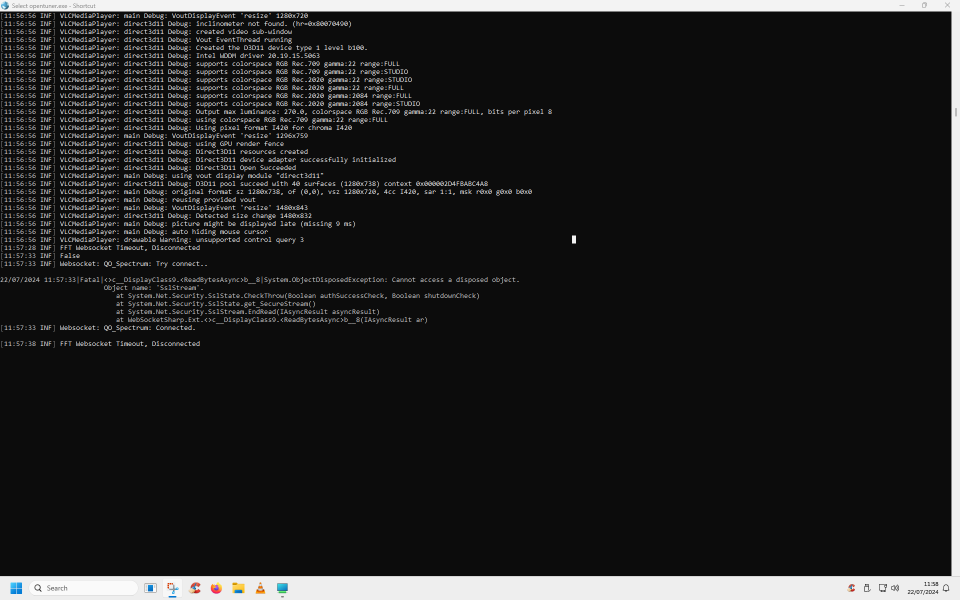

I have a problem , can some one explain why I loose Quick-Tune when I turn the Bias on.
I surppose it is RF going some were any surgestions much appreciated.
I am slowly getting there .This is all new to me this digital stuff Hi Hi .
I can usually solve most problems .(BATC forum is an excellent place for answers to most of my problems.)
This is my very first post on any forum anywhere ever .
Thanks for reading
All done with one finger
MartinImage
Screenshot 2024-07-22 112202.png (136.71 KiB) Viewed 5680 times

Is you OT running a pc with a wifi connection? Are you transmitting which might cause interference with your wifi? I'm only guessing here as I don't know your setup.

No wifi direct connection from pc (desktop usb to pluto to cn0417 amp into PE1RKI 100W LMR 400 INTO 3.5TURN COIL )
The leads from psu to amps may be the problem I dont know .
thanks again
still only one finger
regards Martin
sorry must add separate pc running OT plus MiniTiouner still no WIFI Ihave tried the latest version the same problem

hmm, I think you are right and something is probably not properly shielded or grounded. When this happens is it only OT giving issues, or does your internet go down on the pc as well ?
Sorry, I don't have any more specific answers surrounding your problem as its not something I can replicate on my side.

Thanks for reply .No it only effects OT, as far as i know . i have swapped the PC that i use for OT on, still the same
I do not know were to start with the screening .( THIS IS NOT A TIDY SHACK HI).
Nobody has come back with any coments, so I think the way things are setup at my end
Cheers
73 Martin

Hello Martin, what happens if you open your browser to let's say, Google, then transmit? Does Google disappear? If so I would say RF is getting into the PC or the wire to the router or into the phone line. Does Open Tuner itself crash?

Thanks for the suggestions . No PC internet works with bias turned on .
The laptop is ok WIFI seems uneffected .
I have put ferrite clamps on a lot of what I think are susceptible cables .
I will try and improve screening and earthing over the weekend,
