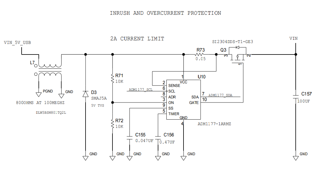

It might be the USB supply that has failed, this happens quite bit with EMC problems. This is extremely hard to fix but you can bypass it and apply 5V directly elsewhere. I have done that once, on a model B. The schematics are on the AD website, but it is a complicated circuit and If you don't understand it and especially the implications of feeding 5V in somewhere, it is probably best not to try. Even if already a write off so seemingly not a lot to lose, there is a risk you could destroy your PC USB port, so proceed with care.
The schematic https://wiki.analog.com/_media/universi ... c_revb.pdf - page 7. For a model B, 5V can be applied at C157 but this bypassing the current limiting and probably best to remove Q3.
Screenshot 2024-06-29 111757.png (70.38 KiB) Viewed 3931 times
