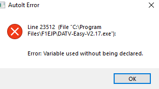

Well my HackRF arrived today......
Installed the driver and it sort of works....but large shoulders if the drive is much above 15%. This was on 437MHz.
It doesn't seem to stop transmitting when 'stop' is clicked.
It produced a signal on 2409.75 but whatever it was it crashed my Ryde immediately.
Not sure what the TX range and capability of this new inclusion is (Device should be 1MHz-6Ghz but I did not see any RF on anything other than 437 and 2409.75 - tried 5760MHz, 51MHz, 71MHz etc...333DVBS2 soft encoding on an I7 Gen 4 which has always been stable.
My Pluto which has been very reliable on V2.17 now won't produce enough RF to drive my amp even without attenuation.
Uninstalled and re-installed both version (singly) and still not got a working system.
If I try and run 2.17 (previously stable) I now get an error message and it crashes....see attached pic.
Perhaps I should have followed the instructions.....but nothing is working now :-(
Update:Fresh download 2.17 unzipped and installed gives the same error message as above......
Re: DOWNLOAD DATV-Easy v3.08
Posted: Wed Apr 17, 2024 4:54 pm
by Basil
Have you had a poke about in the registry with regedit (careful now...) to see if there's any detritus from previous installations you thought were deleted fully? Can be quite illuminating for many applications. I tend to do a drive copy or similar before installing new stuff that is frequently updated "just in case".
Posted: Wed Apr 17, 2024 8:03 pm
by F1EJP
if you want to uninstall completely:
Uninstall the program then you can delete the following directories:
C:\Program Files\F1EJP
C:\ProgramData\F1EJP
and the file C:\F1EJP\param.ini
Then you can reinstall
The HackRF is experimental
For the DATV-Easy 3.08 version I added the driver for the HackRF and the operation is the same as for the Lime Mini or Pluto SDR with the manufacturer's firmware.
I don't have a HackRF myself and it was SV9IOQ who tested it.
I will see if a solution is possible but I am going to Spain for several weeks and will not be able to do any tests.
Thanks for your test and return
73 Dominique F1EJP
Posted: Wed Apr 17, 2024 8:37 pm
by F1EJP
After google rechearch;
https://github.com/greatscottgadgets/hackrf/issues/354
It's seem a problem of firmware HackRF you must try to upgrade the last firmware to resolve this problem.
73 Dominique F1EJP
