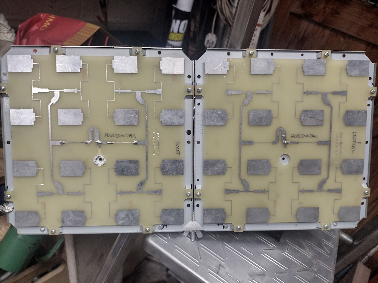

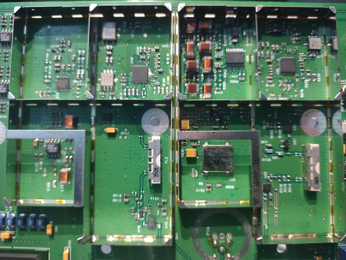

Yes, The flat plate antenna are very easy to adapt to an SMA and have a gain of about 18dBi. I use a pair side by side RX/TX which saves a relay....I have run 40W through one on DATV and nothing went up in smoke. There is also quite a good TXCO with adjustment on the motherboard. Hard to extract from the casing, you basically have to cut all the edge-moulding off- I think they were thermally welded halves.

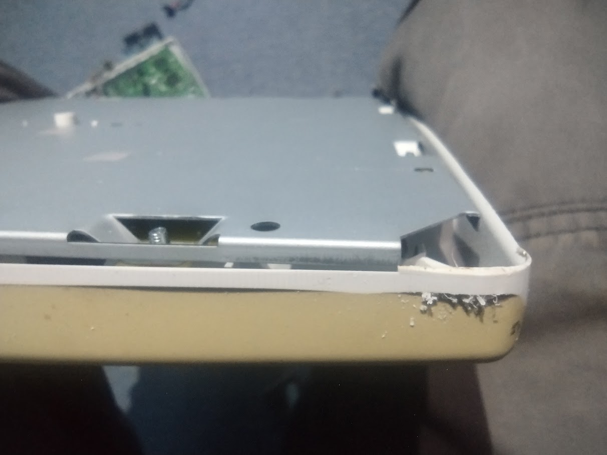

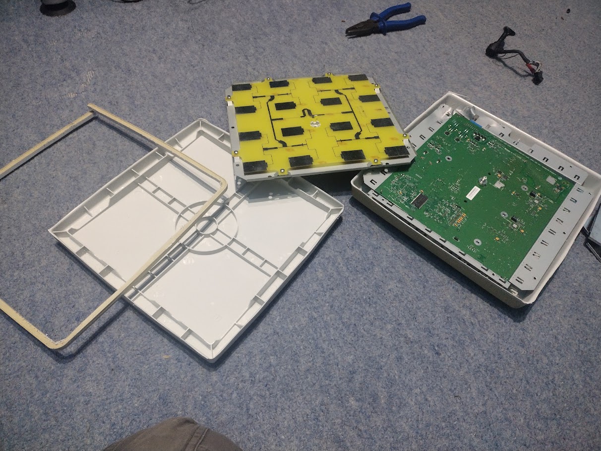

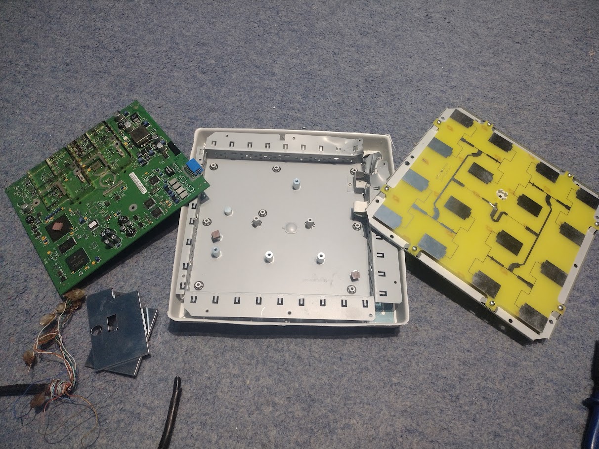

Arrived today, just like the others I bought. RX and TX strips visible but TBH its easier to connect a Pluto/Lime these days, the stuff is TINY!!
Pictures show whats you get and the mounting problem in the old case.
The front cover, once separated, is about 2mm too shallow to allow re-sealing the flat plate, but you could use some rigid plastic sheet, and a non-acetic acid silicon to seal the whole lot back up and bridge the gap between the plastic sheet and front cover, a bit like sealing around a bath tub!. No mounting solution though...
Pictures should expand on this....

Next will be the photos of your mods hopefully. Mine has also arrived so I will be getting the multitool out to cut into one! Then I will look at the electronics.....

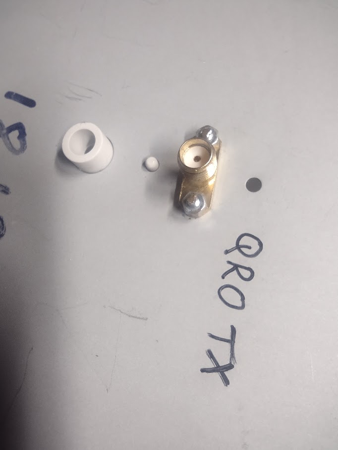

Probably the easiest conversion ever.....
Unscrew the PCB from the backplate, drill mounting holes for your SMA (2 holes enough), bolt on SMA, replace PCB panel and solder centre pin.
Depending on TX power you may wish to beef up the thinner traces that feed the assembly.
My nanoVNA shows VSWR at 1.7:1 at 3.4, a couple of dips further out, one each side of 3400, but that's fine, both my amps have circulators on their O/P.Gareth
