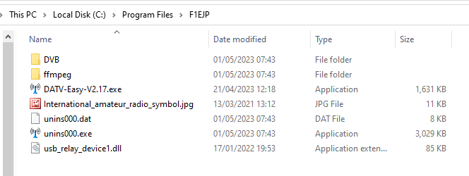

Thanks Martin, I've looked there....by right-clicking on my desktop shortcut and choosing file location....
C:\Program Files\F1EJP is my path and all I can see in the directory is shown below.
As its works perfectly I 'assume' that all the required files are there.....but no param.ini..... So still looking...

Re: Time delays in DATVEasy 2.17
The param file is stored in C:\f1ejp.
It is not stored in C:\Program Files\F1EJP because access to that folder requires privileges, not assigned to a user, to enable writing/modifying.
it's a Windows security thing.

RIGHT, got it, that will teach me to read the answer as it was, not as I thought it was
