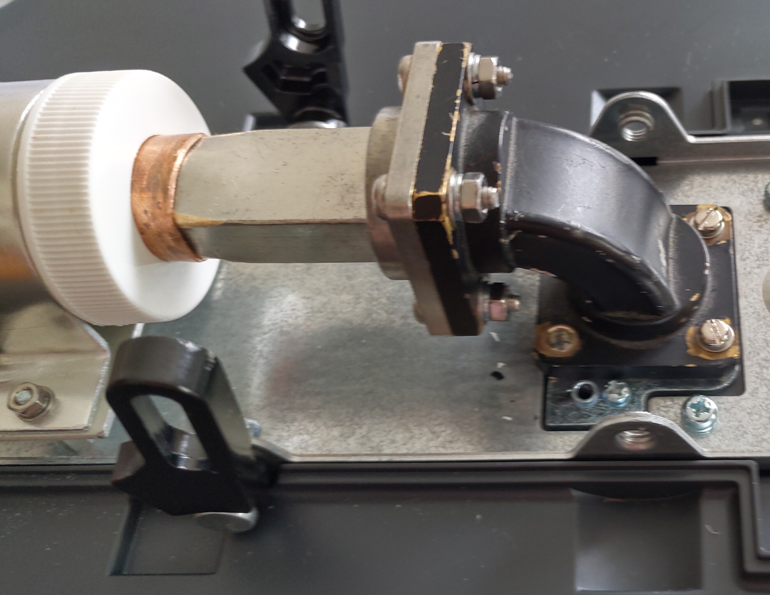

Re: BSB Squarial - anyone got one lurking?
Hi Gary and all,
the Squarial is an interesting antenna, having experimented with it for the reception of terrestrial as well as QO-100 NB signals. I did attempt QO-100 WB reception, but it seemed a few dBs short of performance for success with my setup. Being a passive antenna, I intend to explore terrestrial Tx possibilities also.
I presented my modified unit (with a new LNB fitted) at the Crawley Microwave Round Table last month and if interested have a follow-up article in the forthcoming Scatterpoint magazine of the UK Microwave Group - recommended to join if not already a member!
Attached is a photo showing my LNB adaptation.
Jen
Jen
- Squarial WG Adaptor.jpg (633.27 KiB) Viewed 18842 times
Hi Jen,
I shall look forward to your Scatterpoint article!
I modified mine in a similar fashion to your photo, but I took mine apart to drill and tap two more mounting holes for the waveguide transition.
Unmodified these are circular polarisation, I remember reading a webpage about converting these to linear, but I'm not sure how confident I am in the method. (antenna test range required) BUT this could gain you 3dB, so maybe worth a try?
Hi Gary,
Indeed, the Squarial was intended to receive the UK WARC-77 DBS channels at roughly 11.7 to 12.2GHz, with RHCP. However, at 10.5GHz and with the test setup used, the antenna discriminated by about 16dB between horizontal and vertical polarisation, indicating that it was most likely no longer circularly polarised at the frequency used (being somewhat elliptical probably). If it had been circular, antenna rotation should have not made a difference in received signal level.
In terms of gain, there are a number of ways to estimate this, but the bottom line was how well did it do compared with a reference antenna with a similar LNB? Indications were that the antenna gain looked pretty reasonable, if not quite good, probably down to the efficiency being better than a dish size-for-size.
I intend to put some RF into a Squarial to look at possible transmit capability, with a plan to check the return loss initially and after ramping up power. I have 20W or so at my disposal so will see how it goes!
Depending on RL, a circulator may be recommended for transmitter protection.
Jen

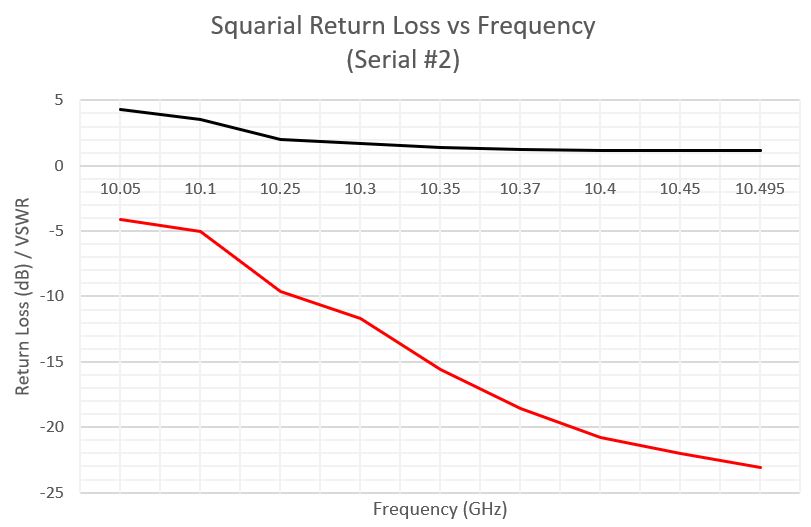

Hi all,
I can see that there has been a bit of interest in this topic and as such I wish to share a preliminary measurement made of Return Loss vs. Frequency for one of the Squarials that I have. These measurements were made at low power (0dBm) and do not necessarily show what would happen if higher power was to be applied, as a some point, internal electrical failure will occur.
I do not currently have access to a Network Analyser, hence the plots were derived from reflected power measured using a directional coupler and should be taken as INDICATIVE ONLY - hence the usual caveats apply and always check yourself before attaching any expensive radio equipment!
Jen
Jen
- RL vs Freq.JPG (56.99 KiB) Viewed 15819 times
