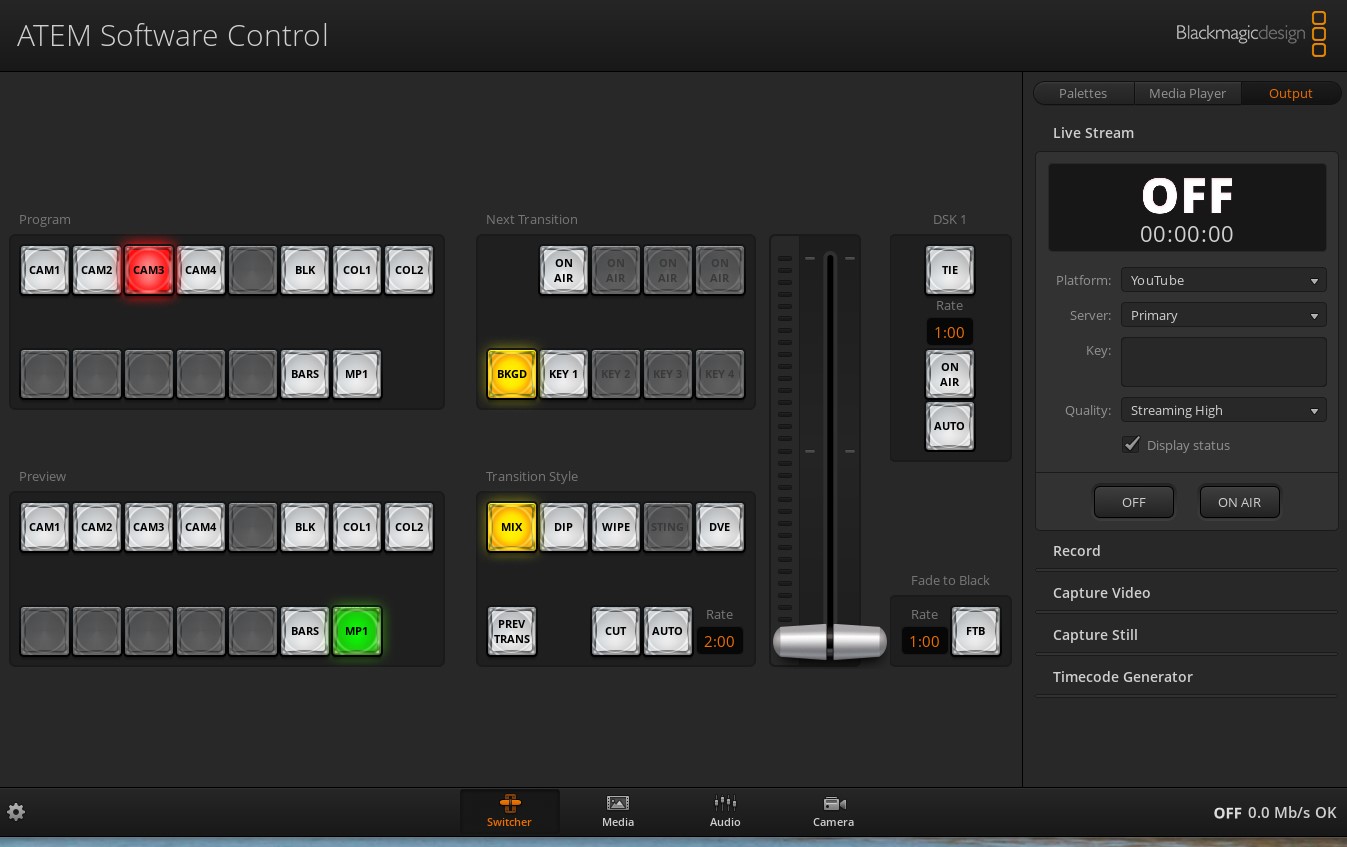

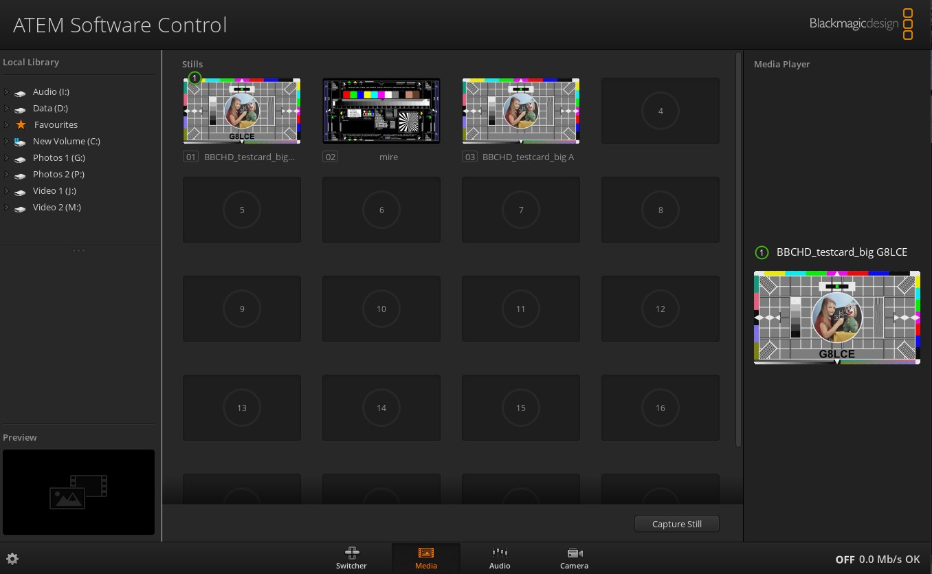

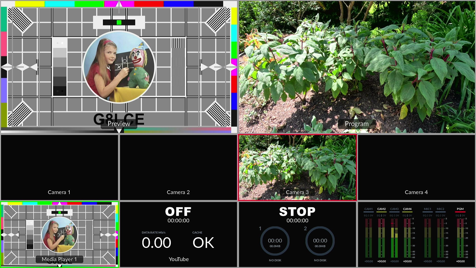

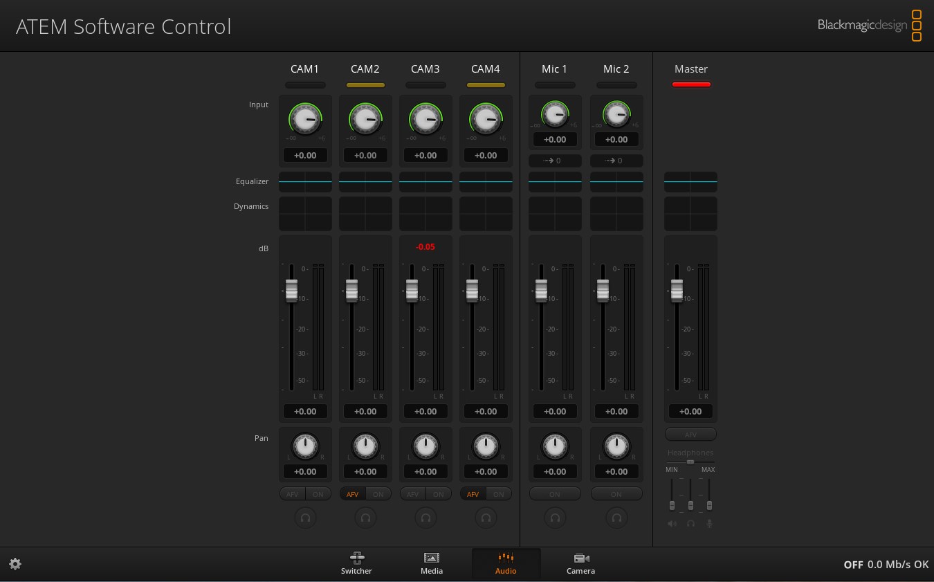

I have been looking at the Blackmagicdesign ATEM Mini Pro ISO for a while and when they appeared in a sale at a very good price, I bought one. They can stream to many of the regular places like YouTube etc. but can also be programmed from a PC to stream elsewhere. This requires an edit of a XML file and some knowledge. This is something I have not done yet but seems very possible. The device itself has many small buttons which I thought may be too complicated but they are quite logical once you play with them. The USB output is used to program the device should you want to upload testcards etc. or control it from a computer. The output is also a webcam input for a computer and would be a good input for the Portsdown too if that was possible...
The HDMI output can be used as the main output or used as the monitoring of the sources and preview and main.
This would be while using it as a webcam input or a stream device (possibly to a Portsdown, Pluto or BATC stream input )
Below are some screen shots of these things.
