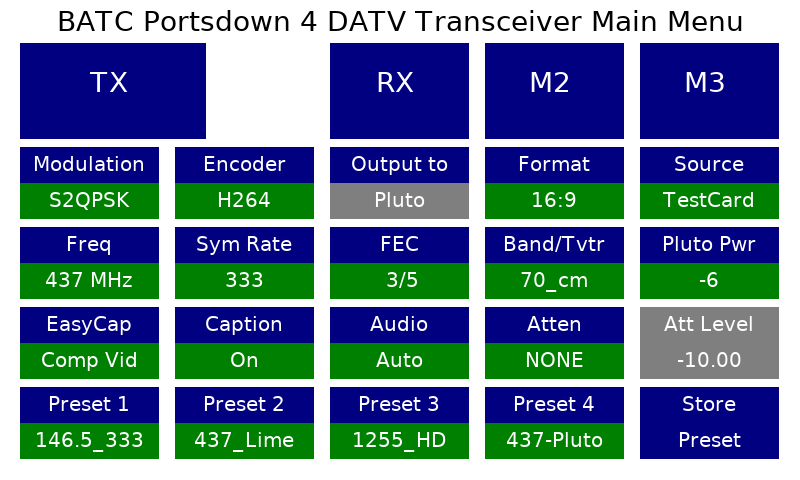

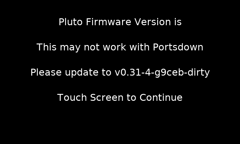

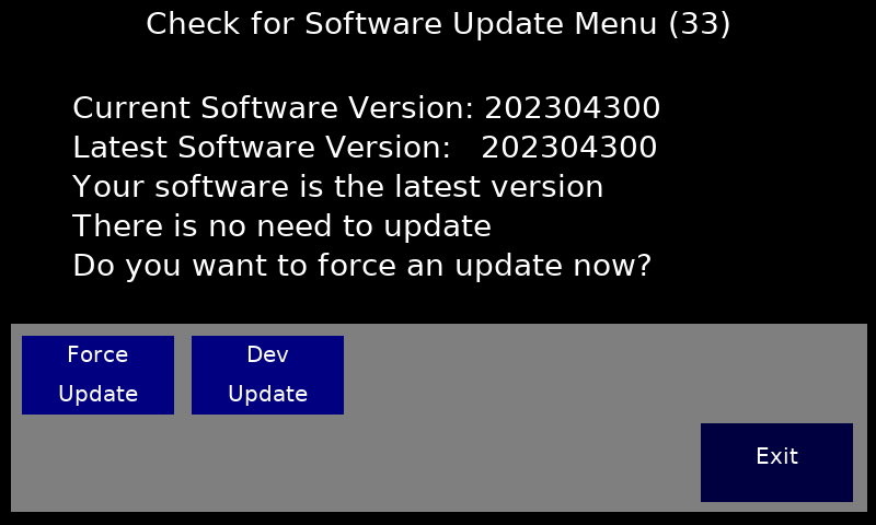

OK, so I thought I would try checking the different firmwares out....
I ended up with a Pluto that would not work with Portsdown!
So I investigated some more....
It is a rev C/D that I have added the extra inputs and outputs to.
Here are the screens from the Portsdown:
- portsdown-screenshot_2023-05-17T14꞉23꞉28.783Z.png (35.33 KiB) Viewed 14349 times
- portsdown-screenshot_2023-05-17T14꞉22꞉36.950Z.png (48.04 KiB) Viewed 14349 times
- portsdown-screenshot_2023-05-17T14꞉20꞉57.227Z.png (23.57 KiB) Viewed 14349 times
I tried different Portsdowns and got different answers.
Finally I rebooted the Portsdown and it all began to work again!
I had tried rebooting the Pluto ( M3 - Pluto Config - Reboot Pluto )
I had tried a Portsdown reboot ( M2 - Reboot )
but it took one more reboot for it all to work.
Other Plutos and Portsdowns did not give the problem.
I had cleared the Pluto firmware by Formatting the device and reinstalling the pluto.frm
I checked the firmware versions of the Portsdowns - all the same.
The only difference may be the starting point for the SD card as the Portsdowns are different ages.
Anyway the 'fault' has corrected itself. The point being if you are not transmitting or something is not right, try another reboot!
And yes if I redid the screen shots they would be normal now.
Martin G8LCE
