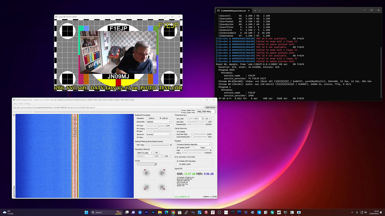

I also captured today, quality looked really good!
Although I used DVB GUI with the pluto, but its a pain in rear end for tuning :-) Will try MT next time.

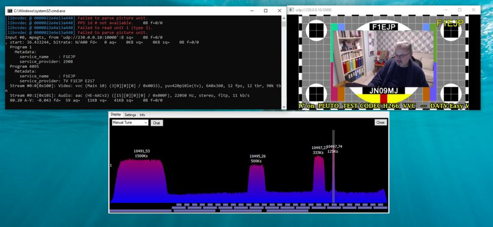

Decodes are not very CPU intensive at all, and the results from low rates were excellent, I'm looking forward to Easy 2.17 to see how intensive Tx is, and how my PC copes. Thanks Dominique and beta testers!
