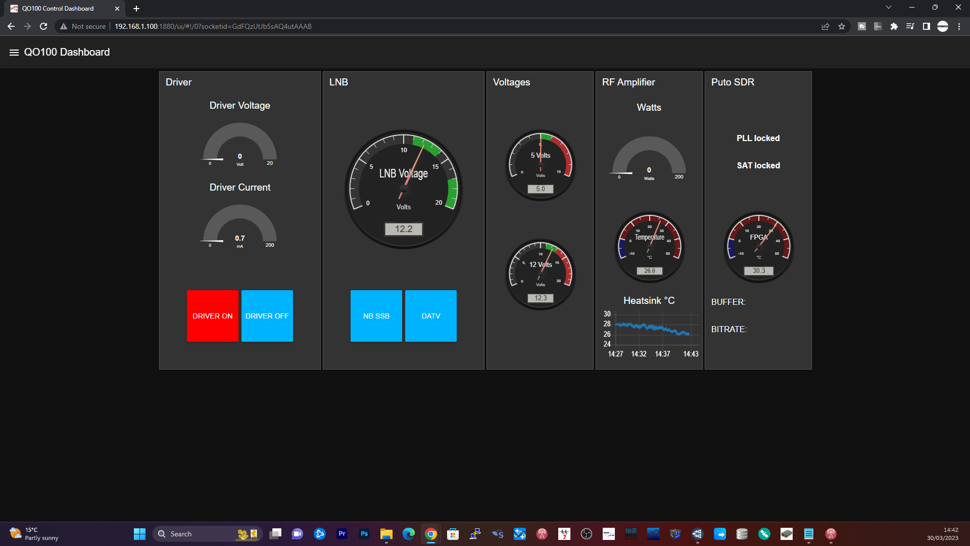

I've just got mine working today.
I use node red and a RF8000 Chinese power meter. I have tried with AD8317 modules but could never get the calculations correct.
The RF8000 has a serial output, which contains the dBm value. So I have a separate Orange Pi Zero 2 running node red. The RF8000 connects to the OPi USB port to provide a Serial/USB channel.
The RF8000 is connected via RF to the sample output of a 40db coupler, with another 13db attenuator.
I then use node red on the OPi to send the dBm value over MQTT, to the broker that is already running on the Pluto 0303 firmware.
Then, on my main QO100 transceiver, within Node Red, I just subscribe to my dBm topic and show it on my dashboard. Ofcourse I also convert this dBm value to Watts.
Yes, I know its a long winded way of doing it, but it works lol...
Matt
