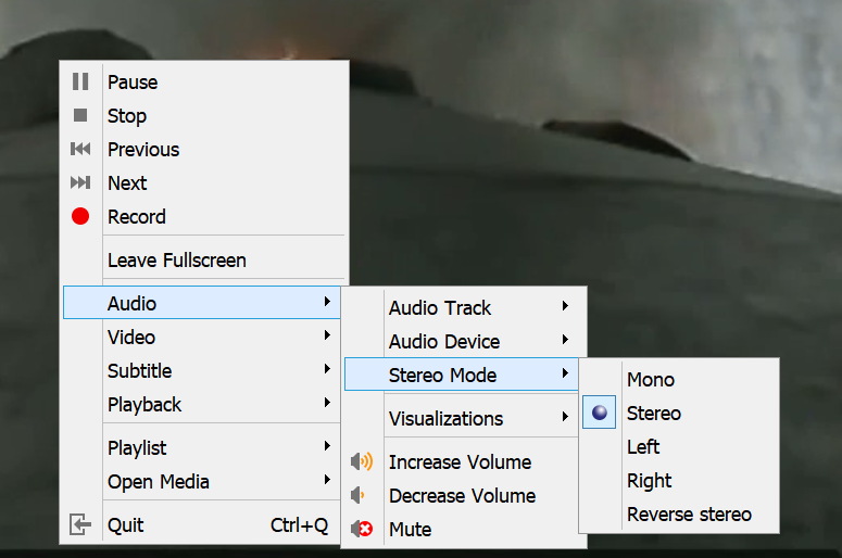

I recall a similar case recently of odd audio behaviour. Try looking at and selecting different options in VLC. Right click on the VLC window and then select AUDIO / STEREO MODE. Also look at AUDIO TRACK and AUDIO DEVICE.

I'm watching your transmission of the woman dancing and sometimes there's audio and sometimes there isn't. Is that expected? I tried all the VLC stereo settings, but it didn't change anything.
