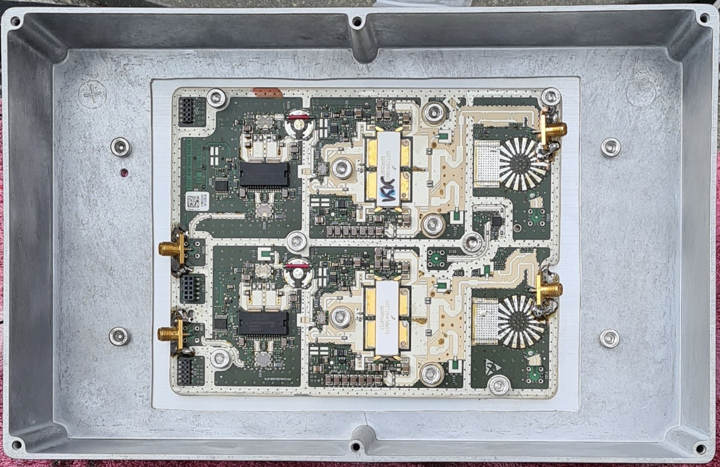

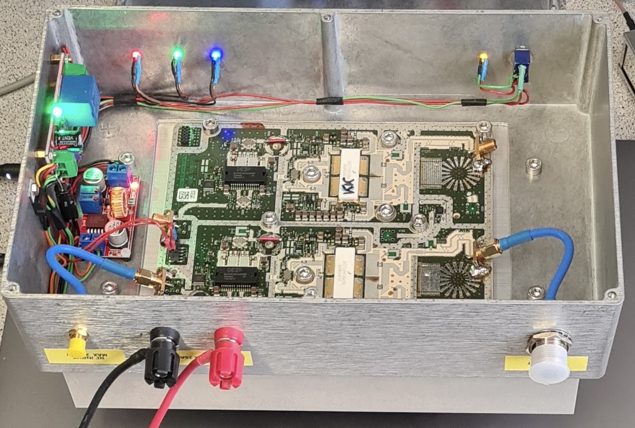

2,3GHz DOUBLE QRO RF linear amplifier, 2x BLC9G22XS-400AVT with cover.
Is there modification instruction available for this or another one present at e-bay ?

That PA reportedly doesn't modify well, however this one does.
https://www.ebay.co.uk/itm/204036129772
73 Dave

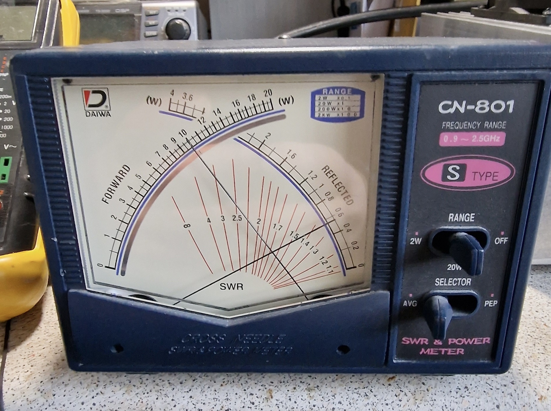

Hi, this pallet modifies well mine gives a good 100watts on both sides.
Posts: 2735
Re: 2.4 PA in ebay
Post by g0mjw » Mon Feb 13, 2023 10:04 am

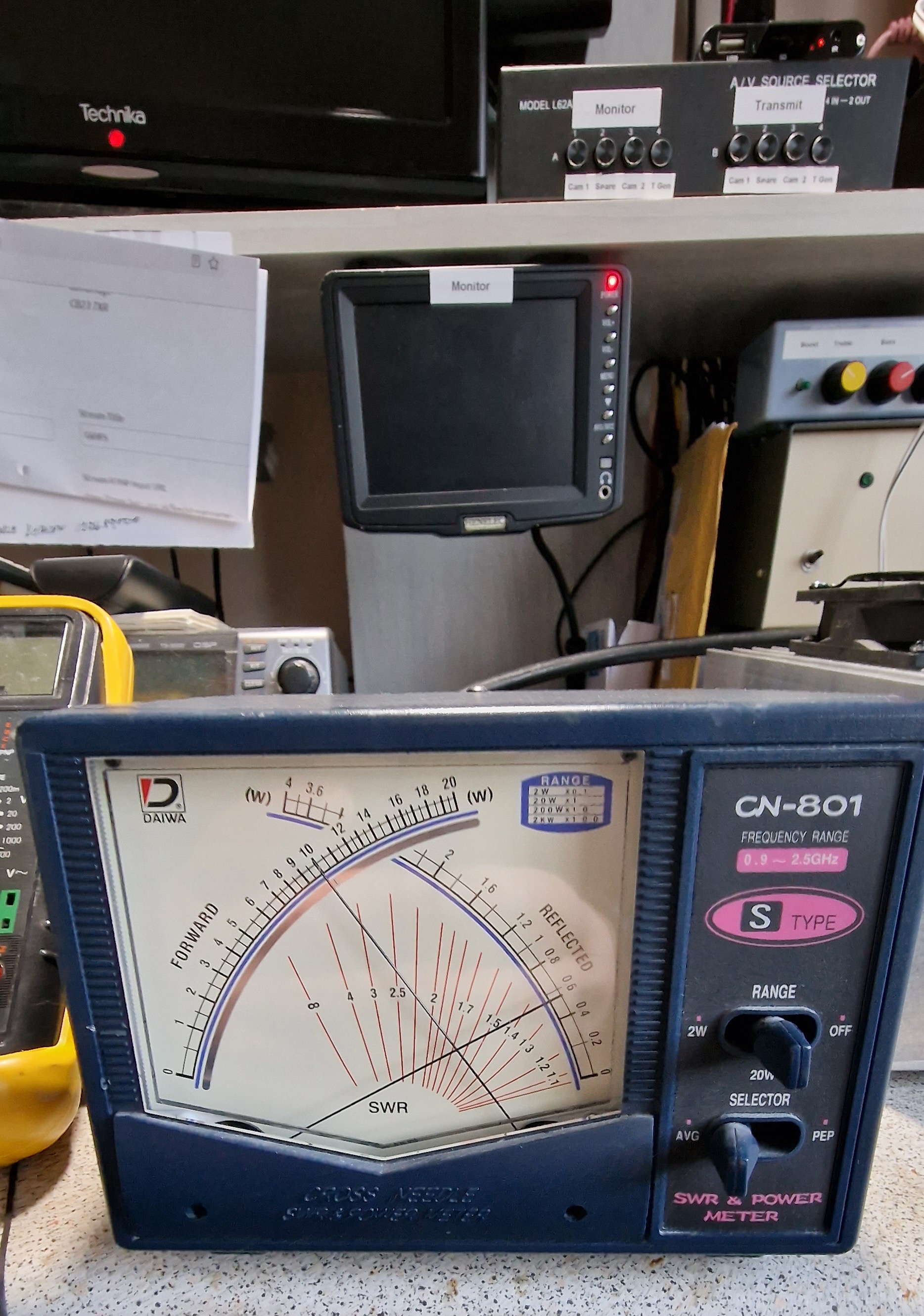

That's only 10W?
g6hfs
Posts: 338
Re: 2.4 PA in ebay
Post by g6hfs » Mon Feb 13, 2023 10:30 am

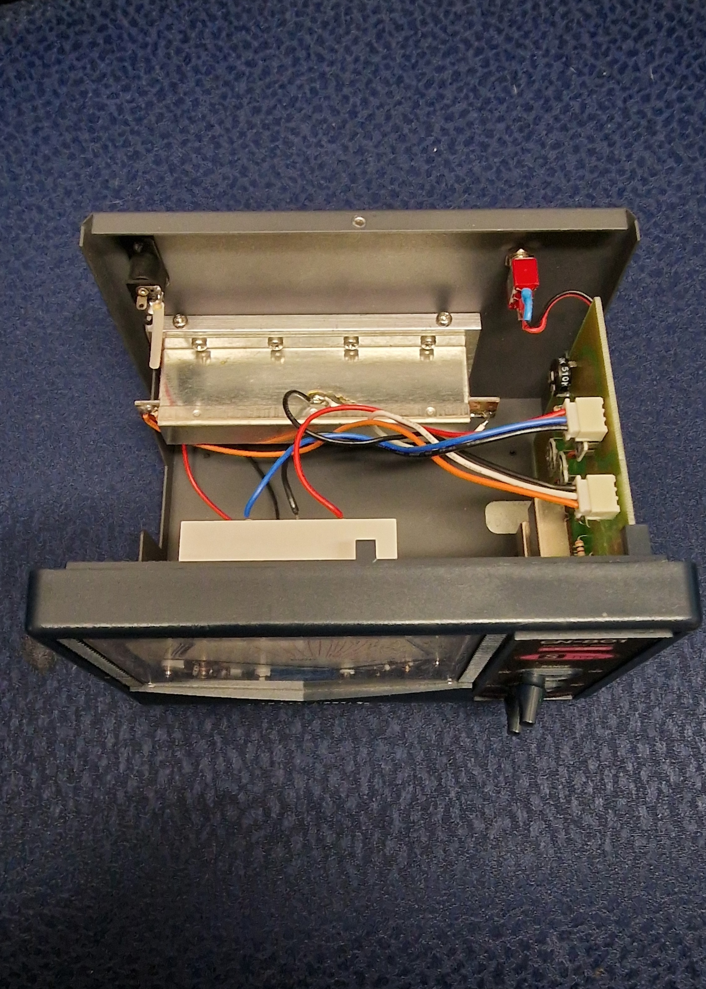

Hi Mike,
it has a switched multiplayer, look top right corner x1, x10 and x100 it’s switch to x10
Posts: 2735
Re: 2.4 PA in ebay
Post by g0mjw » Mon Feb 13, 2023 12:32 pm
Interesting. I thought those meters only did low power as written on the switches on the front. I could have bought one for 23cm last year but passed as it only went to 20W.
Is there another switch on the back? If so they could be useful given the difficulty in getting power meters at 2.4 GHz/
g6hfs
Posts: 338
Re: 2.4 PA in ebay
Post by g6hfs » Mon Feb 13, 2023 1:07 pm
Hi Mike,

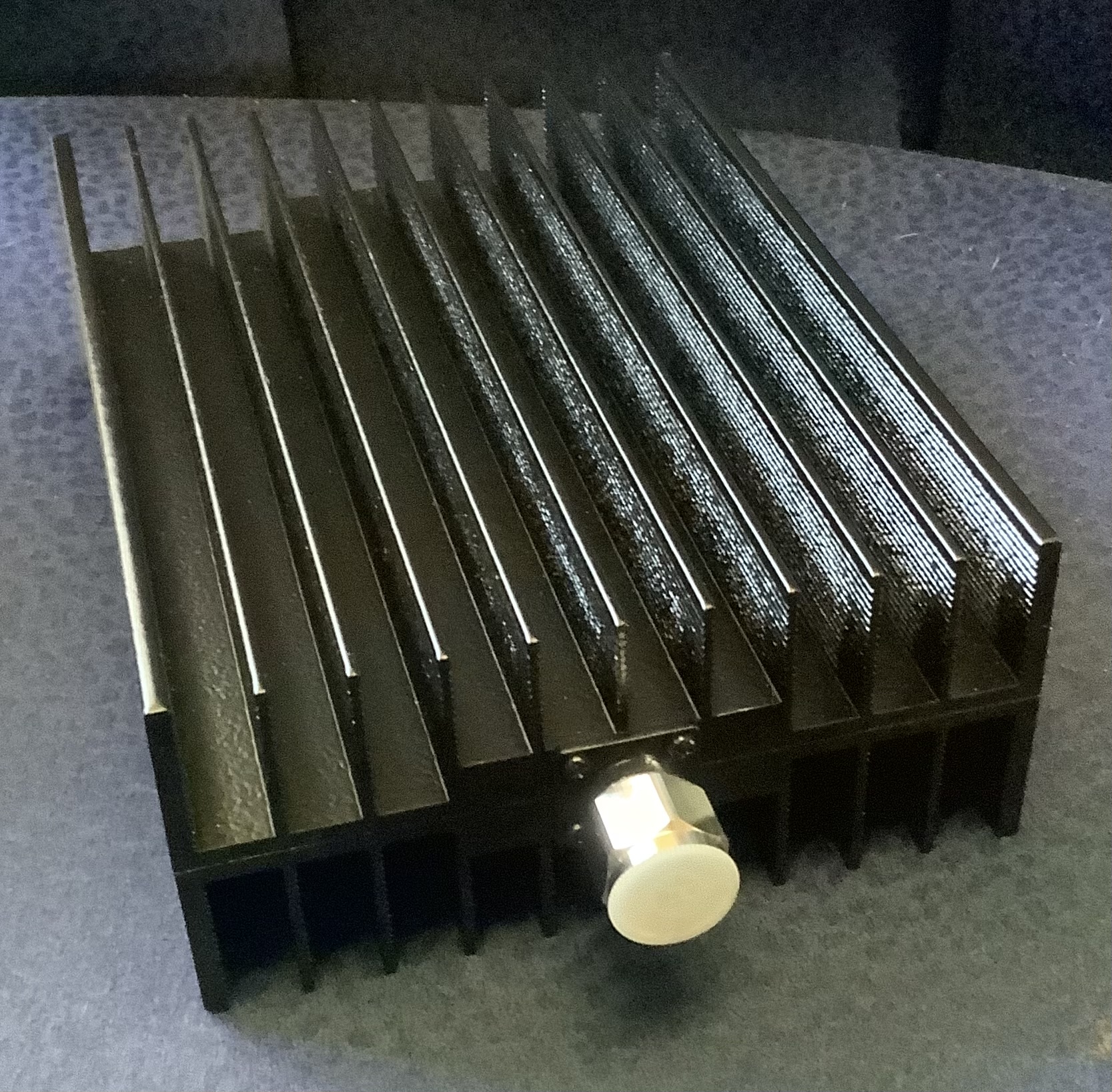

This is the S version, back when I bought it they offered to do the mods to the V (200w) model they added the switch and fitted components required to the pcb, and calibrated it but that was a good few years ago, also have 200w dummy load for 2.5GHZ. (still gets quite warm at 100w)

Thanks from info, I bought one unit Yesterday
One practical question about removing component.
Instruction says that using hotplate, i do not have hotplate
Just thinking if they can be removed just mechanically and rest with heatgun ?
i have also re-soldering unit with vacum pump ?
