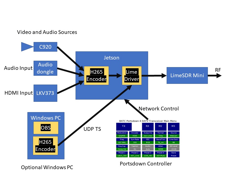

I have been tidying up the Portsdown code (trying to tackle my to-do list!) and also rebuilding my QO-100 setup which uses a Jetson Nano.
The idea of the Jetson Nano is to use it as an external H265 encoder and LimeSDR driver, controlled by a Portsdown on the same network. Preferably with no windows PCs, keyboards or mice involved - just touchscreen control from a Portsdown. The existing setup is shown below.
I occasionally use an external PC with OBS and an F1EJP H265 encoder script to drive the system, but this is an anomaly and not ideal. It was forced on me by the need to have captions available for the QO-100 Net.
The existing code supports HDMI input through an LKV373A, C920 (Mk 1) and EagleEye WebCams, Audio dongle and test card.
I am prepared to work on supporting other input devices. First on the list will be the Elgato CamLink HDMI dongle, which I have here. For other devices, I would need loan of an example for implementation and initial testing. Ideas might include an ATEM Mini or other USB-output HD devices.
To make it perfectly clear, I am not prepared to broaden the scope of my work on the project; no touchscreen or desktop on the Jetson. No connection of keyboard or mouse during operation. Only LimeSDR Mini SDR, not Pluto.
Within those constraints, I am looking for ideas of what people want and will use.
