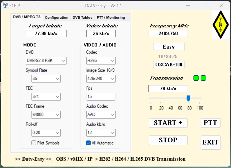

Re: DOWNLOAD > DATV-Easy V2.12
Thanks for another update
I can't get any SR's below 66ks to run. Using OBS V27 with virtual camera, Intel I7 gen 7 laptop with either Intel or Soft coding.
I get the message "Vidrate is too low - modify parameters" but I can't change Vidbitrate as its automatic?
Am I doing something wrong or is my laptop not up to the task? I have tried DVB-T, DVBS and DVBS2 and am using a RevC Pluto 0303.

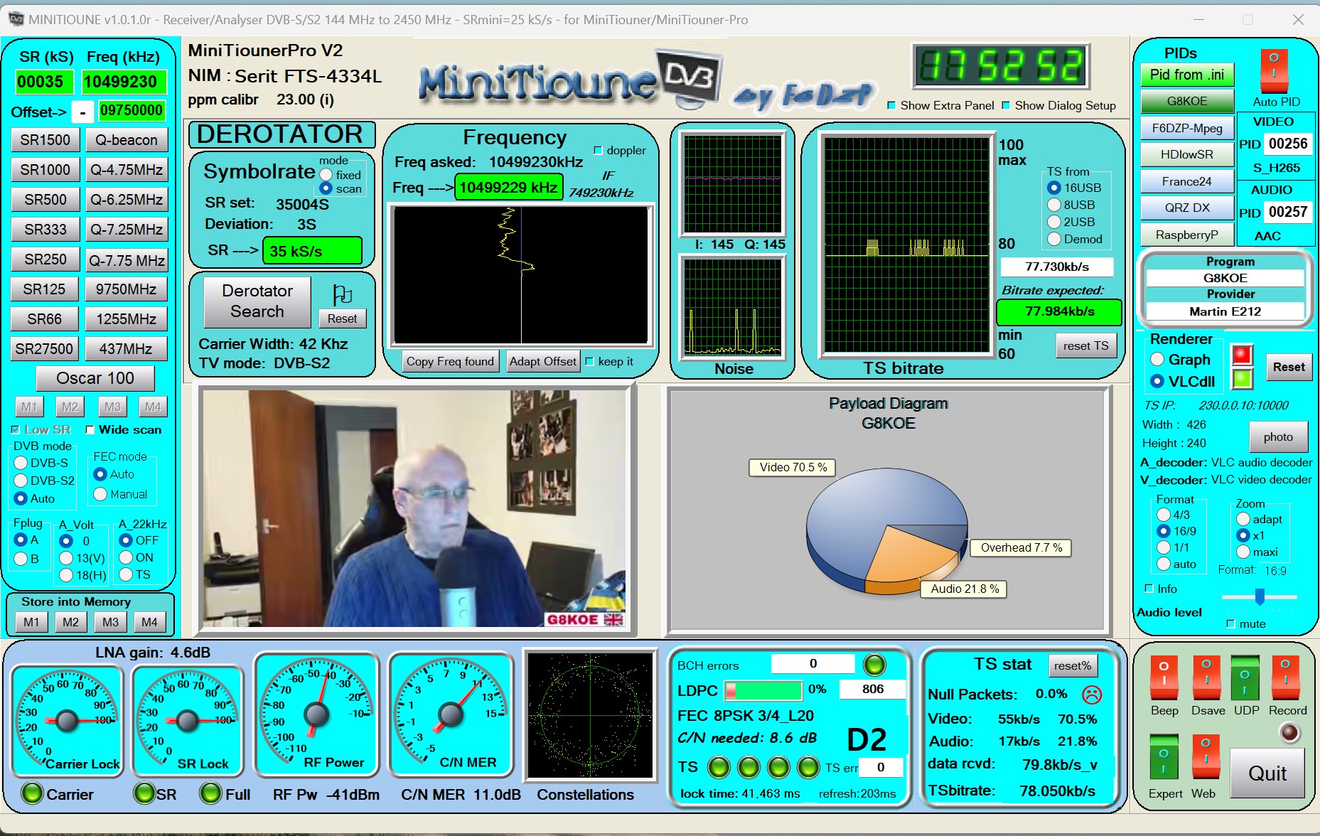

Hi Gareth,
Just been testing DATV Easy V2.12 working through QO100
DVB-S2 8PSK
35Ks
FEC 3/4
Win 11 i7
NVIDIA card
OBS28
73's
Martin

Thanks Martin, I have now got that working too.
I assumed that because I could choose almost any combination, that it would work.
I could do with a list of 'permitted combinations' but that said, now I know which parameters to mess with, I have a 20ks 16apsk DVBS-2 signal coming out which SDRAngel is trying hard to decode.
I still have to match the parameters on the Pluto webpage but that seems 'logical'???
Progress though.....
