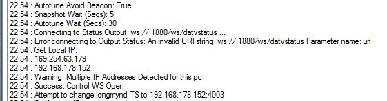

I have both Longmynd and DATV Receiver for winter hill installed.
But ..
After overwriting the Lomgmynd dir with the new installation I find the settings has been populated with correct valus of IP etc.
When I check debug I see this
longmynd error.JPG (28.77 KiB) Viewed 5880 times
Nick

Post by G1BVI » Sat Nov 26, 2022 11:19 pm
Ignore my last within settings Status websocket output was enabled
