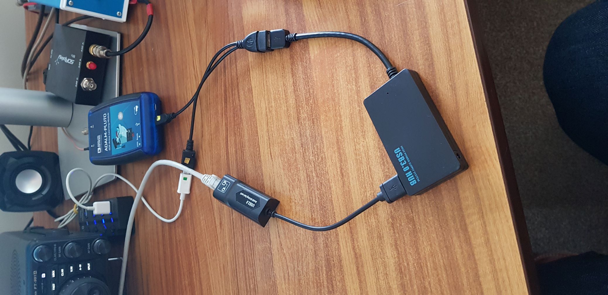

My Rev B Pluto would not work with my USB network adapter.
The Rev C Pluto worked no problem.
Trying different firmware have settled on v0.33 and a USB hub between Pluto and network adapter see pic.
I found firmware versions gave different output levels v0.33 was good.
With this combination my Pluto appears on my network and works with DATV Easy V2.08.
