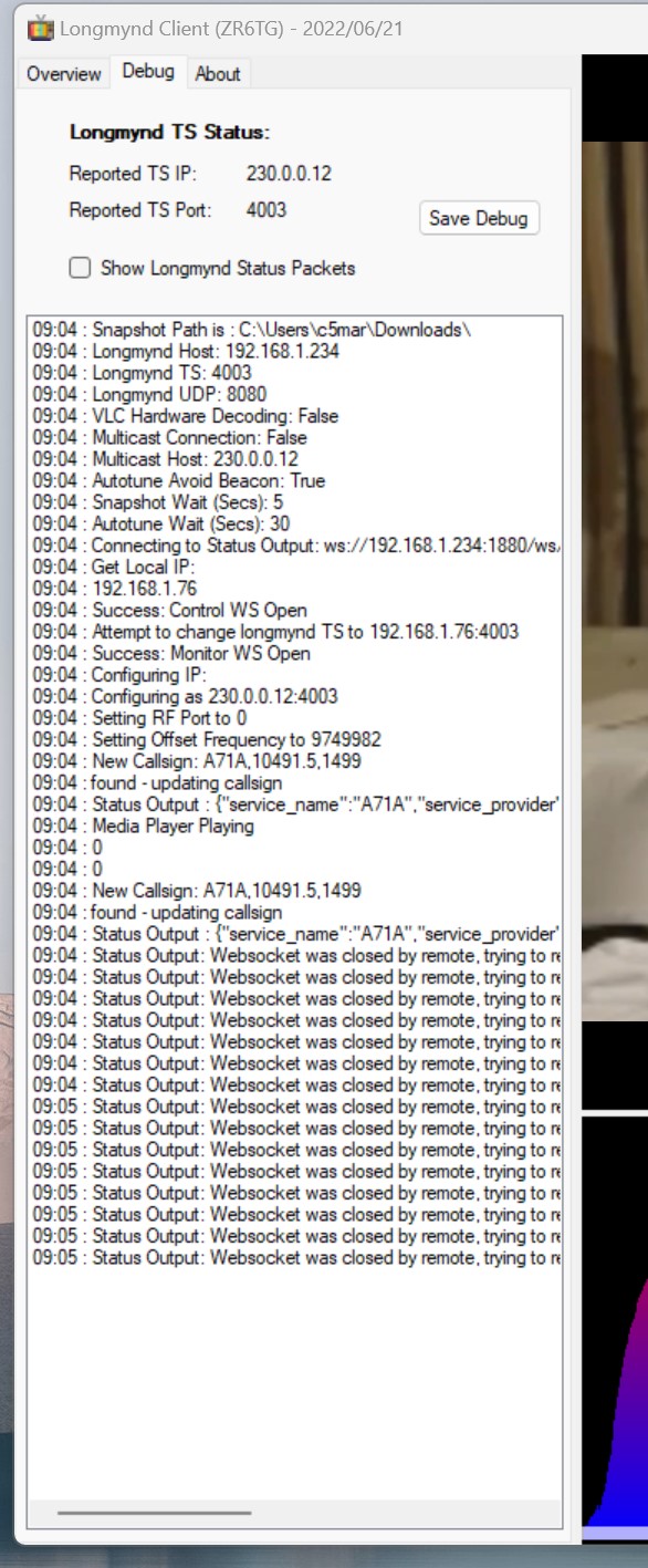

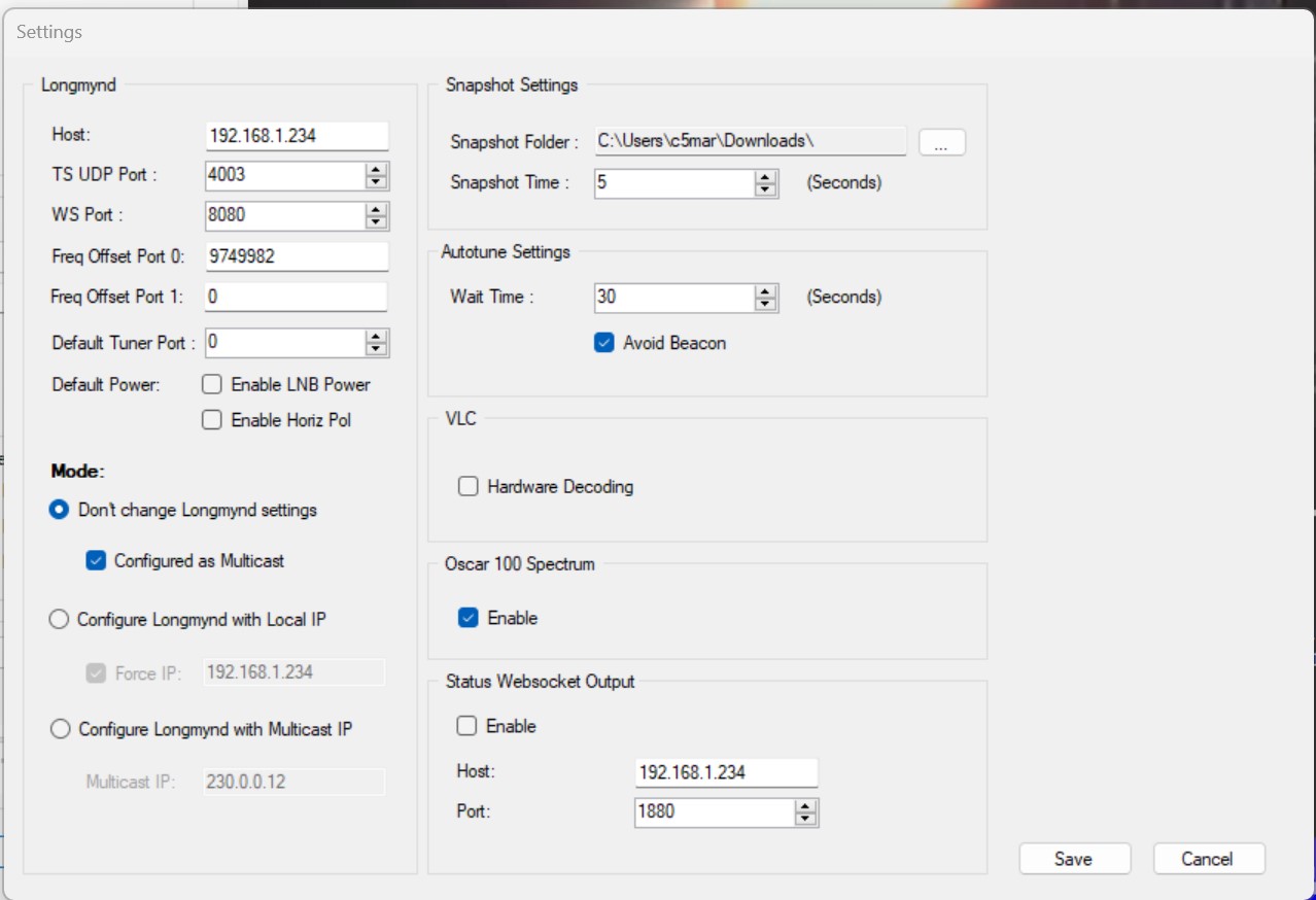

Update to my progress.
I have configured the Lonmynd Client to Multicast and all works on my laptop.
The problem has shifted to my main PC see pics.
The debug shows Status Output Websocket was closed by remote, this connects OK on my new laptop.
Next to find out what needs to be change on my main PC.
Slowly making progress!
Any help appreciated as I find it hard going but will get there.
73's
Martin
G8KOE

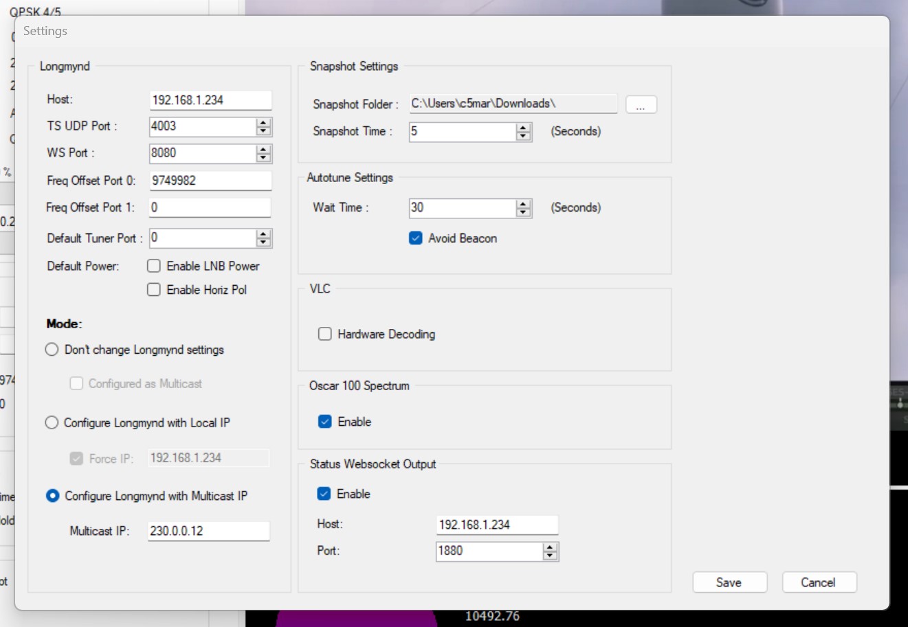

Just got Multicast working on my three computes.
Main PC and two Laptops all running Lonmynd Client at the same time.
I have attached my settings hope this may help someone.

Hi Martin,
I saw your websocket output was checked and if you do not have a websocket client on the specified adres you obvious get this debug error.
The debug shows Status Output Websocket was closed by remote.
It was made to get messages out the Longmynd client to an remote adres where in mycase a raspberry with node-red is using this message to send a telegram message to my phone containing a activity of a special pre selected call is on air...
Its a feature not many of you will use...
And try and error is a well know procedure to get everything working.. nobody likes to read the manual...
Benno
