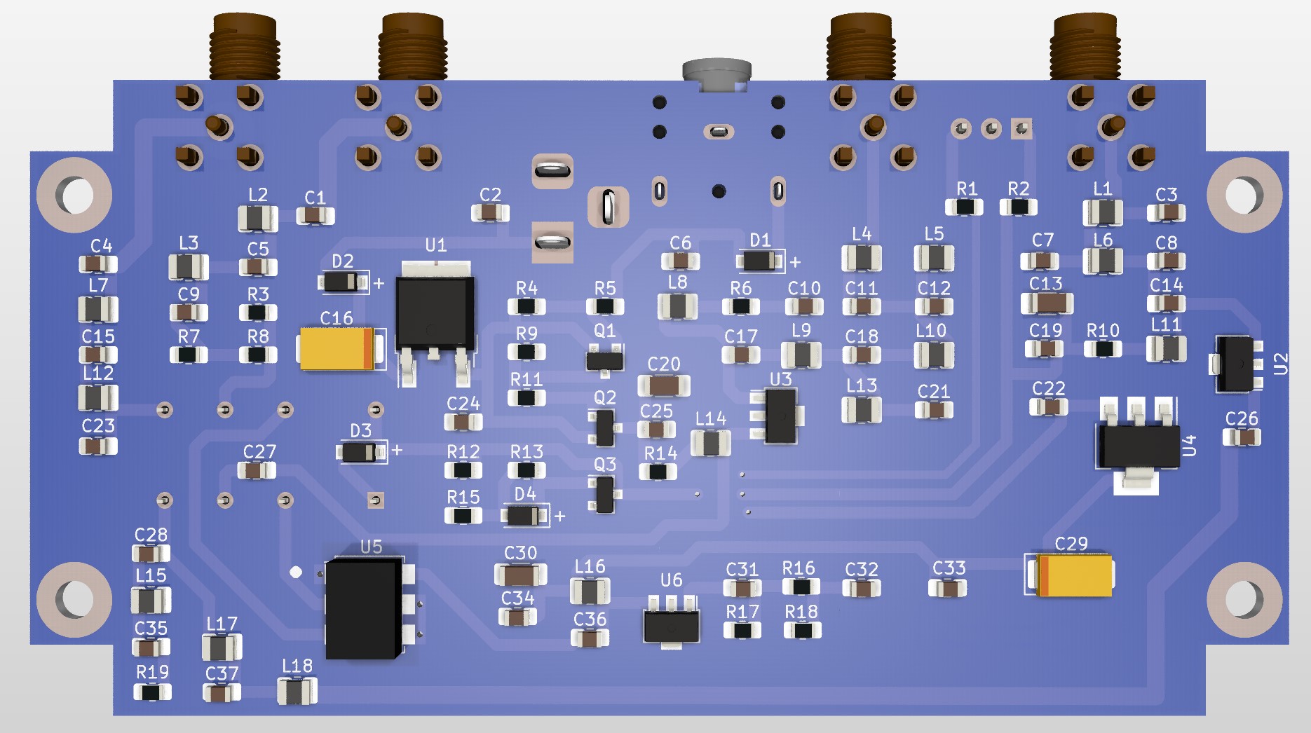

My transverter was for 10m from 148-149 MHz.The older version had a penchant for oscillation, but hopefully the revised one doesn't. It does not do 6m. It is a fairly basic no-tune design so to do 6m the filters would need to be changed.
Another option would be to use a 10m to 2m transverter in reverse. Apart from some niche users, now there are 2m multimodes, there must be many of these now sitting unused in draws. Disabling the PA would be easy.

- Screenshot 2022-11-03 190903.jpg (296.64 KiB) Viewed 14752 times
- Screenshot 2022-11-03 190754.jpg (203.69 KiB) Viewed 14752 times
