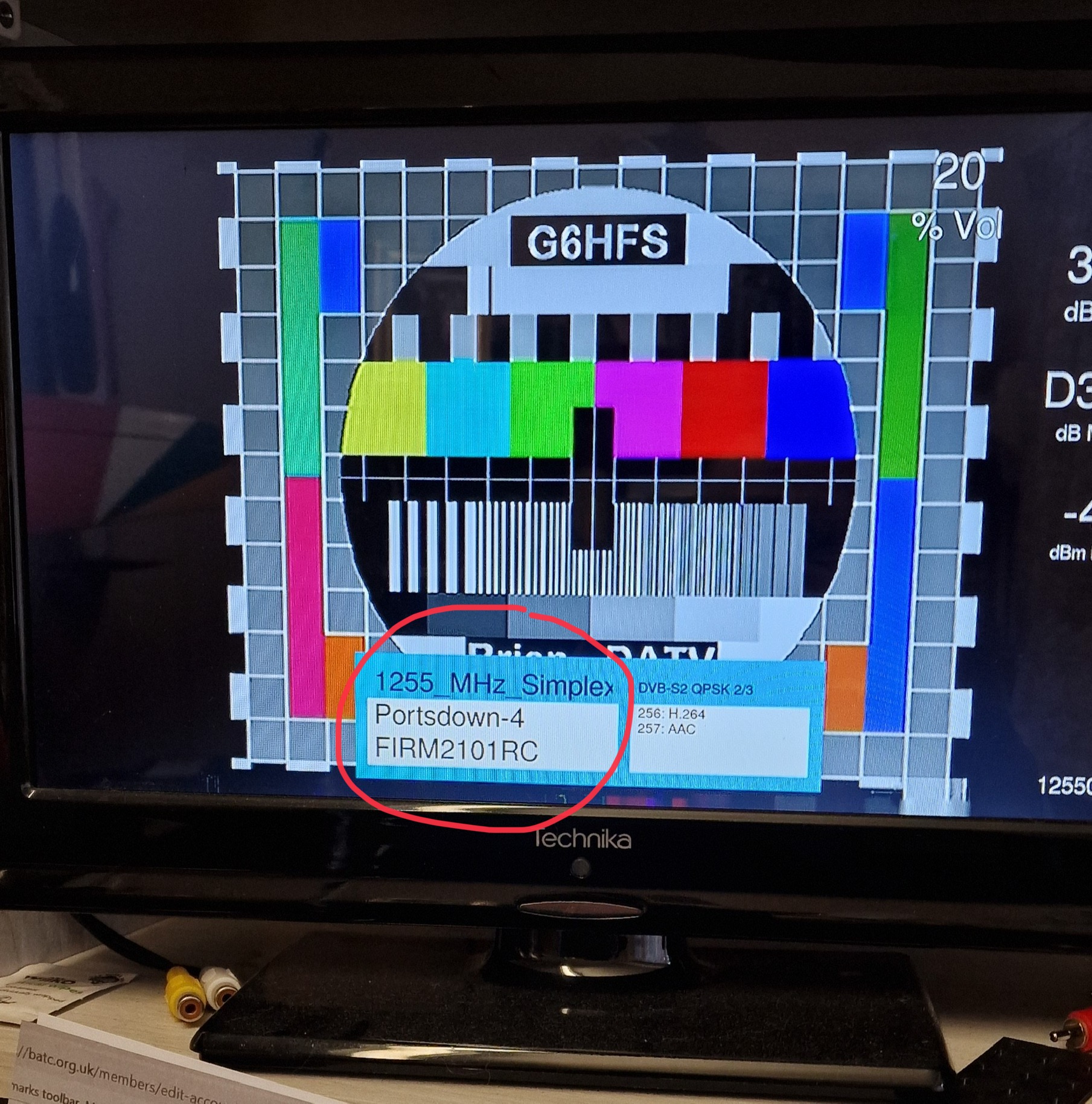

After setting up my new pluto which work fine, I noticed the info box on tx which comes up for a few seconds now has FIRM2101RC displayed, my question is can this be removed or changed.

This info,

That field is hard-coded within the Pluto firmware and is not easy to change. You can change the field that says Portsdown-4 to your callsign or any other string without spaces.
