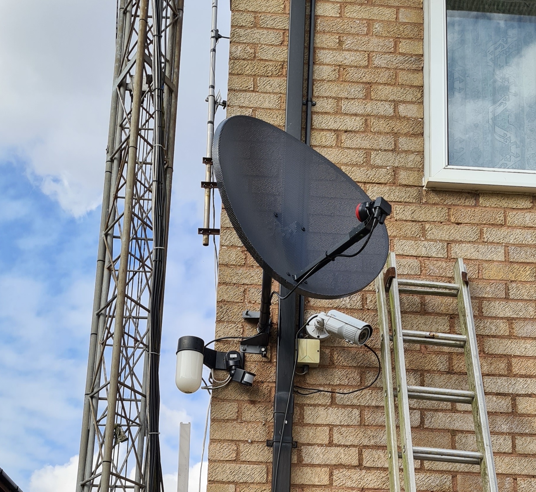

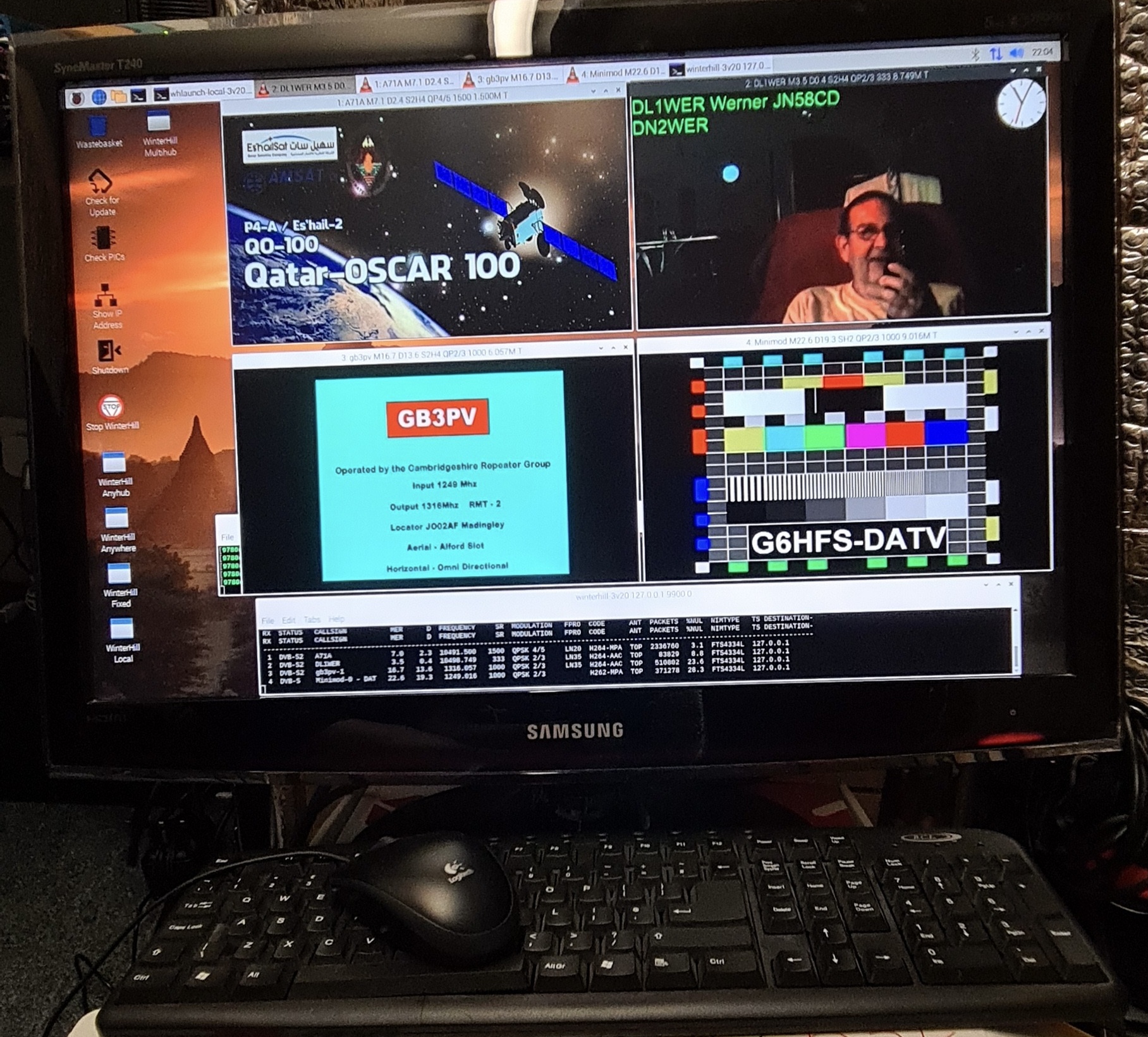

I have just put up an 80cm dish with the bullseye lnb and get good signals at 7db and MER of 2. perhaps a change of lnb may help.
Brian G6HFS
Brian G6HFS

I think you mean an MER of 7 an a margin of 2 dB. That's good for an 80cm dish. There looks to be more than enough space for a larger dish though. Nobody will notice it, they will be too busy looking at the tower.
