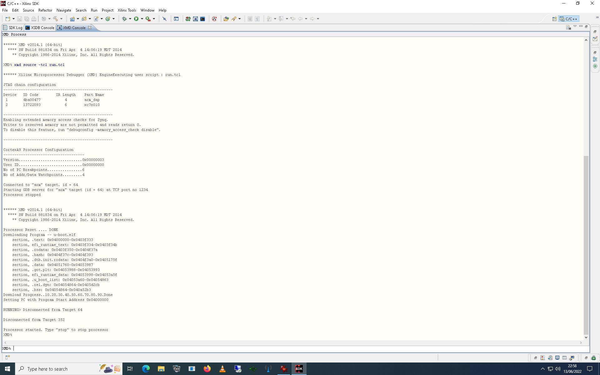

Now sorted thanks, what a nightmare, but learnt a lot in the process... Not for the feint hearted :) Normal dfu mode reset is trivial compared to JTAG access.
http://www.chriswilson.tv/sdk-ok.jpg
I am mad busy with work right now, but once things calm down I will try and document the procedure. If anyone is desperate to JTAG into their Pluto my e-mail is on QRZ, fire one over and I'll give you my phone number and I'll try and talk you through it. you need the two devices in the link in my first post though. I might be persuaded to have a go at yours if you send it me, but I need to get the 10 way pins that should have been with the AD board, but were not. I soldered 1/8 W resistor lead wires in as pins, and it was a delicate job that I'd rather not have to do on someone else's Pluto :)
